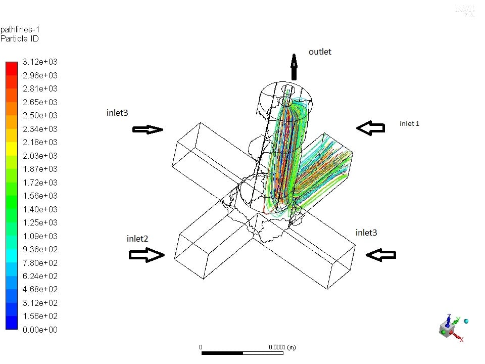

      Hi, I encountered a problem with fluent 18.2.
      I tried to simulate the velocity field inside a mixer. But I found I could not draw pathline for this mixer, no matter starting from the inlets or the outlet(reversed). I tried to draw mesh with ICEM and mesh, both 18.2
      Nearly all the path lines failed, and the the console said: Can't figure which cell particle is going to -- ABORT Cannot find intersecting face for particle 210 -- ABORT
      It seems that the failures happen at the interface of wider channel and smaller channel.
      Thanks in advance.
      path lines failed entering the small diameter channel

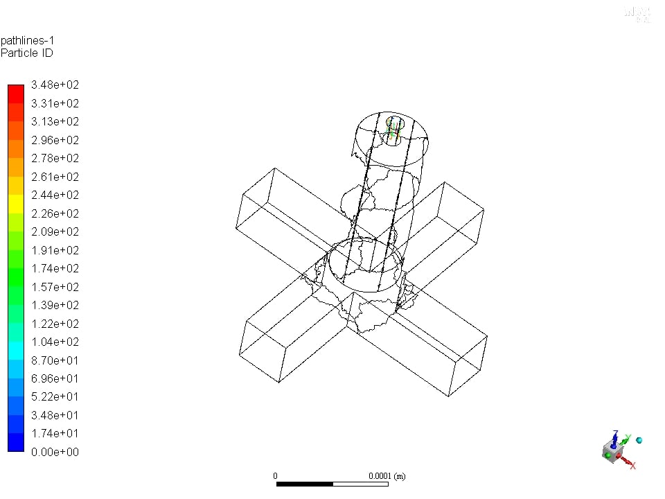

    • yg327
      The pathilnes start from the outlet by clicking ''reverse'' in path line dialogue. But the pathlines stop at the interface between the main channel and small channel. Thanks a lot.

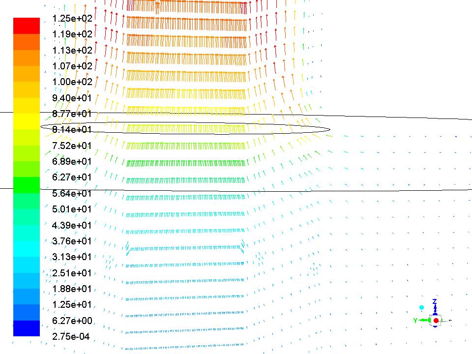

      Do you have a non-conformal mesh at that location? Please plot the velocity vectors on a plane through the cylinder centreline (plane of constant x or y).
    • yg327

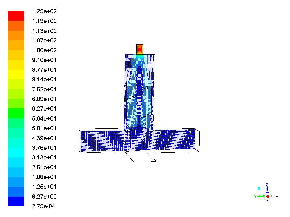

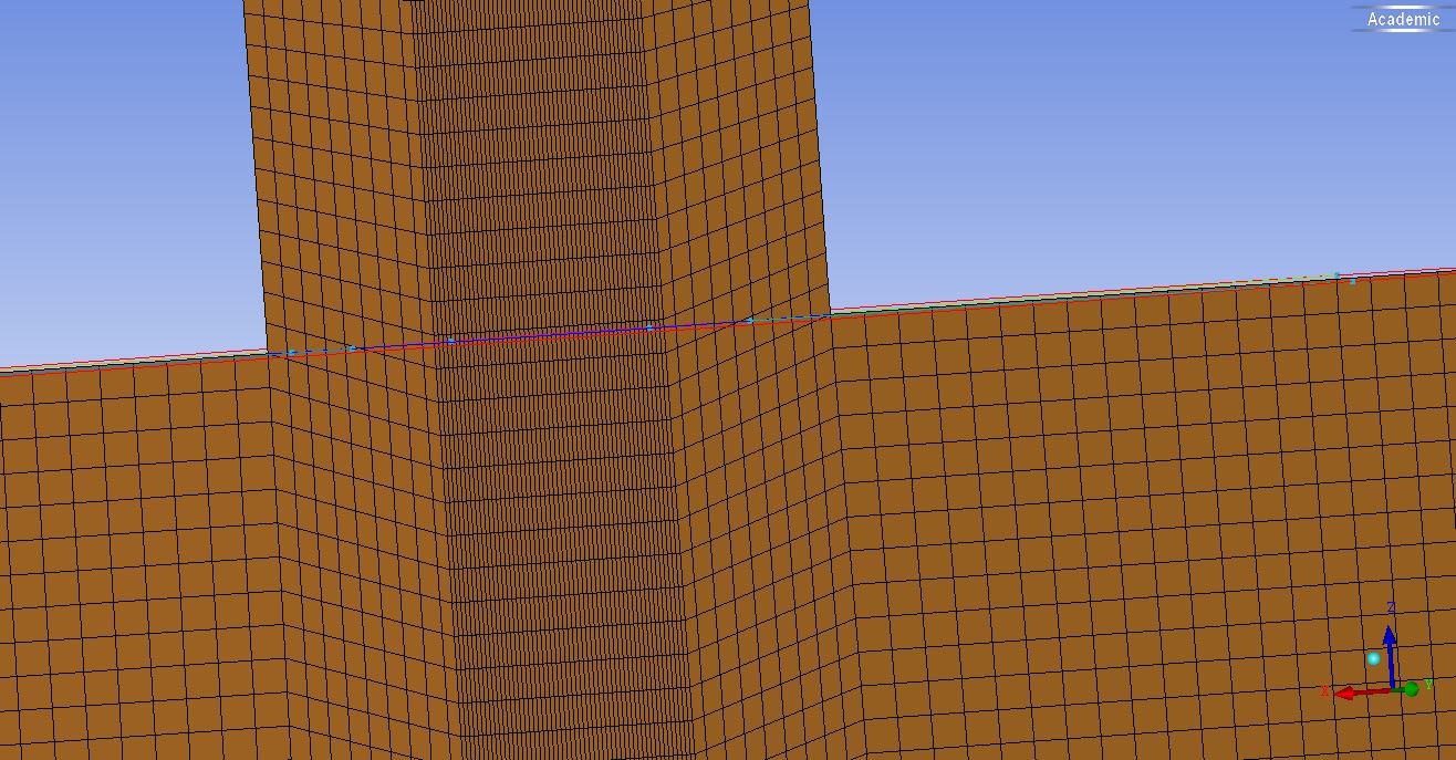

      Many thanks for your help. I uploaded the mesh (by ICEM) and vector. I have one doubt about the mesh quality. It seems that the aspect ratio can be high. will high aspect ratio cause aborted pathline, please? Thanks again.
       mesh by ICEMVECTORVECTOR NEAR THE NECK
      Possibly, but I'd look to improve the mesh for accuracy reasons too.  If you reduce the step length in the Pathline panel it may help: the jump in cell size is also likely to cause problems.
