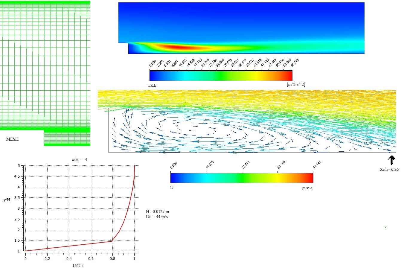

      I created a higher density mesh near the wall in order to solve fine gradients, basing myself on the value of y + for first cells through a calculator on the internet and obtained a mesh with values of y+ = 0.765 for the first cell adjacent to the wall, which was later confined by the Wall Yplus contour in FLUENT. My mesh was dense just in the y direction. In the x direction there was no locality with greater density than another. The mesh created was orthogonal structured.

      From the vectors it was possible to see the absence of the primary bubble, only the secondary bubble configuring a single bubble in the recirculation region. As in the image below. Together in the image has the graph of Cp that is very close to the experimental, the Cf with this behavior that I described, both for the k-omega model. I tested std and SST k-omega and std k-epsilon, all presented similar results.
      I do not have the Driver and Seegmiller paper and I do not know if for the configuration of his experiment, the recirculation region has two bubbles, I think so. I think that maybe the mesh in the region of the wall of the step (vertical wall) may be favoring this result, which at the same time I think not because before in the approach of Jovic and Driver the two bubbles were captured and the graphs of Cf showed the double change and different behaviors for different models of turbulence.
      I think the problem may be what is seen in the contour of Wall Yplus, maybe high wall values can generate these results. I have not yet tested calculate a profile on an input channel and set it as input in a reduced BFS domain. And I have not yet tested a mesh with a higher density in the x direction near the step.

      The question is around the Cf chart and recirculation zone. As I said in thread I tested several ways to get numerical results close to experimental. Now I get close results, but in recirculation zone my solution computate just one bubble in the recirculation zone and through the Cf chart we can see that no have two changes of sign, what indicates one more time just one bubble. So, Why?

      Just to clarify, did you solve the model using fully developed turbulent profiles as input conditions (vel. inlet BC)? I am pretty sure you must have double-checked all your input conditions to your model? Also, how big are the two recirculating regions in the paper? What is your mesh resolution like? Can you plot the y+ values from your simulation?

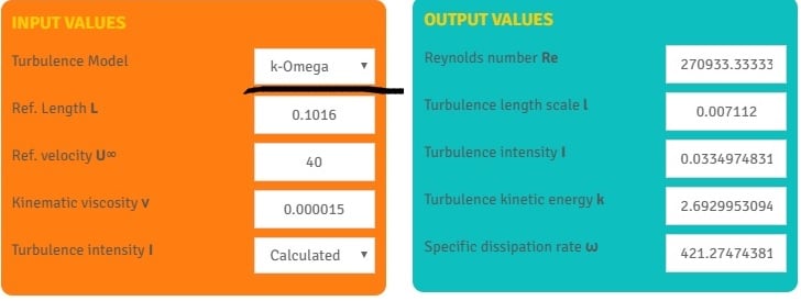

      So, I dont use a fully developed, but I create the domain with the inlet channel of 40D (D is the length of inlet) in order to obtain a fully developed profile. To set my conditions I used a "Turbulence Calculator" in web and I got this values in image below. I used k and omega as inlet turbulence parameters and turb. intensity and turbulence length as outlet conditions. The recirculation zone length measured by experiment is around Xr/h= 6.26 +- 0.1.
      About the Wall Yplus Kremella, have in a image in the thread post. The value for cell adjacent to the wall is around y+ = 0.765. I'm guessing I'm having this result without the initial bubble because of the length of the cells from the step. Maybe they have to be half that size. I'll double the number of cells in the x-direction and see what happens.

      That is the next thing I was going to ask you - mesh density in the streamwise direction. Please let us know what you find when you add more cells near the step in the flow direction. You might want to make use of the bias factor in meshing to reduce the overall cell count.

      As you can see, I got a satisfatory reattach length and a good velocity profile at station x/H= -4. I will try to make this, soon I share here the results.
