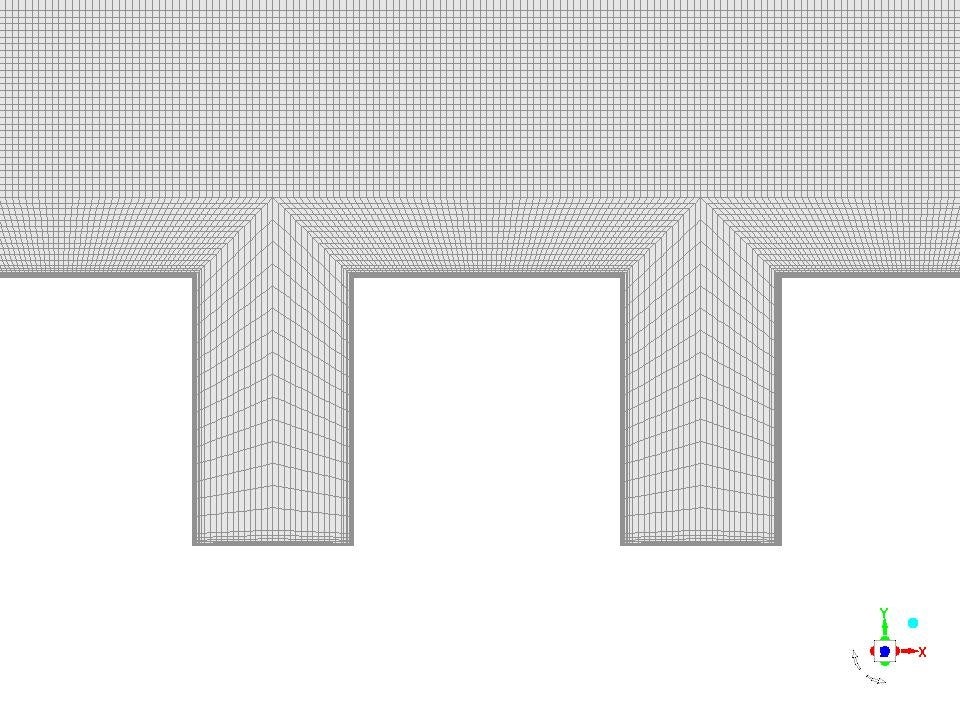

I'm trying to simulate an array of nine cubes using structured hexahedral mesh as shown in the pictures. In this simulation i need high accuracy for flow variables just above the cubes. Also, I'm using k-w sst turbulence model, since it has a good accuracy for both close and far from the walls. After the simulation, y+ values near wall boundaries were way above the recommended value for this turbulence model.

AdministratorHello I would try and stay away from a mesh with hanging nodes. This is a simple geometry - all rectangular blocks. You should be able to generate a good hex mesh without hanging nodes here. The domain might need some decomposing and you will need to perform the share topology operation at the CAD phase. Here are some videos that might help you. This is a 5 part video and I'm only sharing the 1st part.
Regarding your y+ question, after you have fixed your meshing workflow, I would decrease the first layer thickness further. You should be able to estimate, for the Reynolds number in your problem, the desired 1st layer thickness. If I'm not wrong, there are y+ calculators available online.

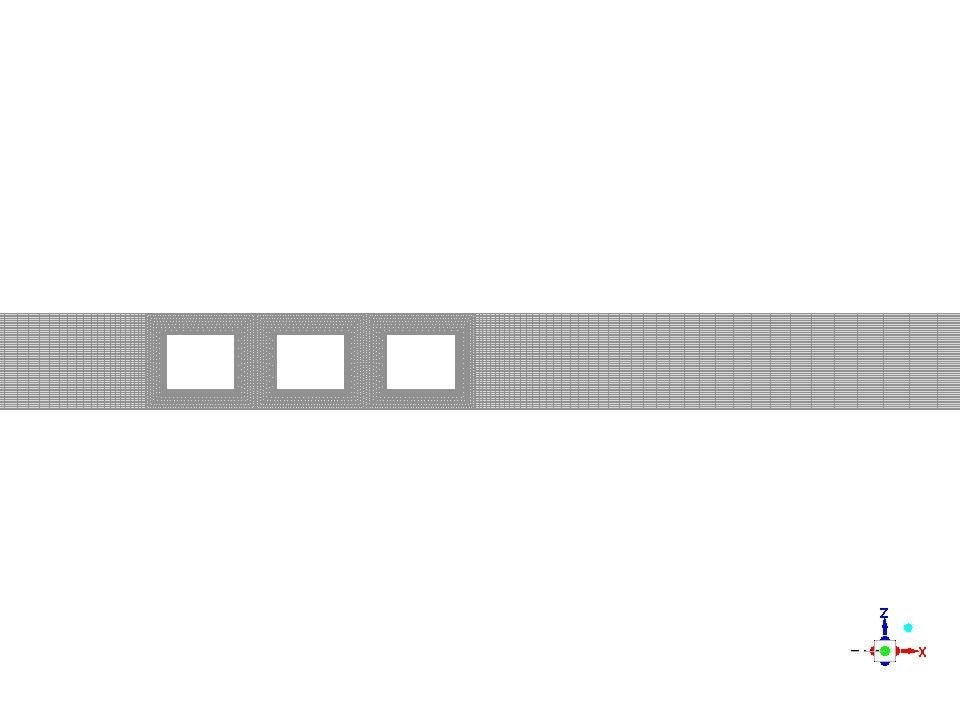

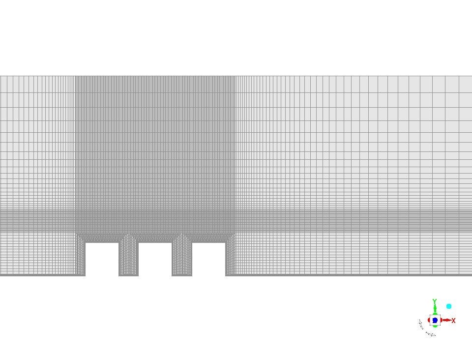

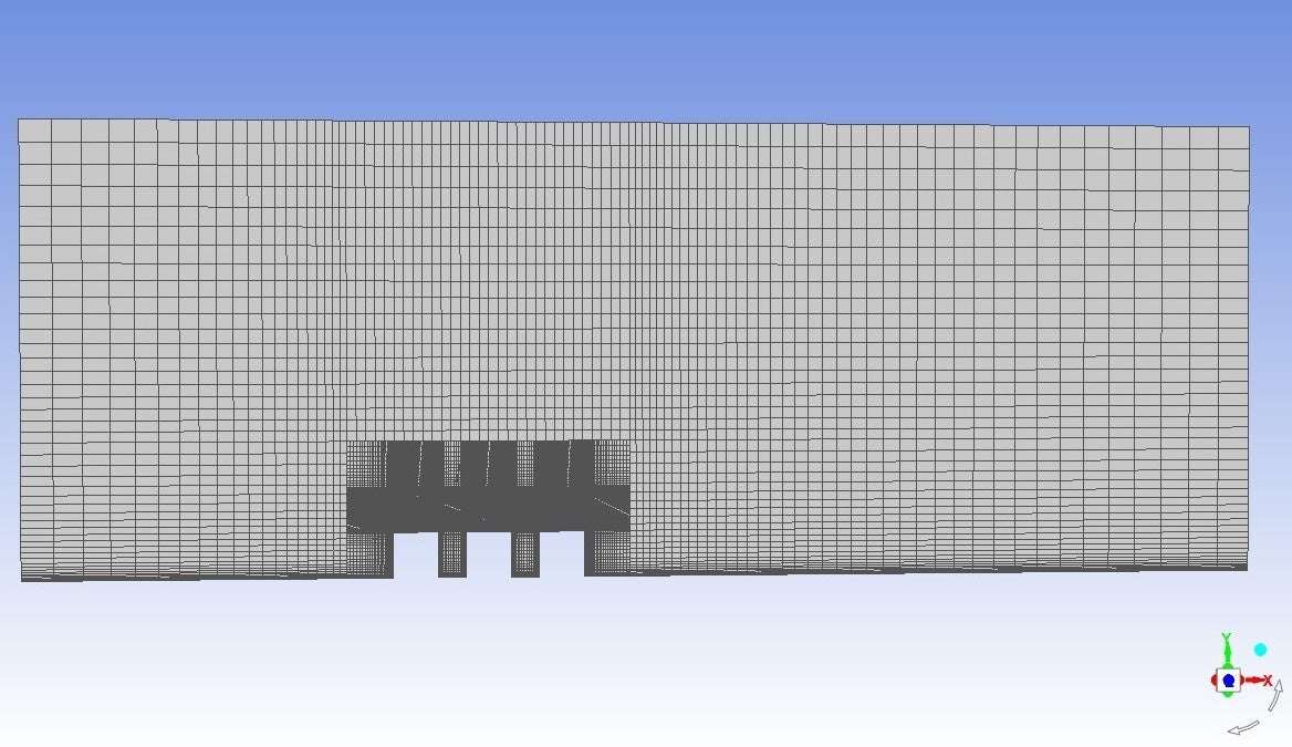

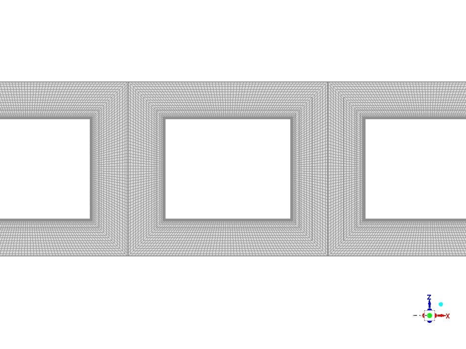

SubscriberHello again So I've been working on this problem and tried different domain sizes, mesh resolutions and mesh strategies in the past month all with no acceptable results (I couldn't validate my results). In my latest attempt, I reduced the number of cubes to 3 and used symmetric boundary condition on the sides of the domain to simulate the existence of the other 6 cubes. I also eliminated hanging nodes as you suggested. I'm posting a few pictures of my current mesh here:
But now my solution diverges after around 30 iterations ! Check mesh didn't fail only gave a warning about aspect ratio and my minimum orthogonal quality is around 0.5 and orthogonal skew around 0.4, I also checked my boundary conditions several times but couldn't find any issues. I'm feeling too frustrated with thisWhat is wrong here? Is it a mesh problem?
November 8, 2021 at 4:02 pmRob
Forum ModeratorThe jump in cell size and aspect ratio is most likely the cause of your problems. Either decompose the domain or just use poly cells. Don't use the blocking like that.
