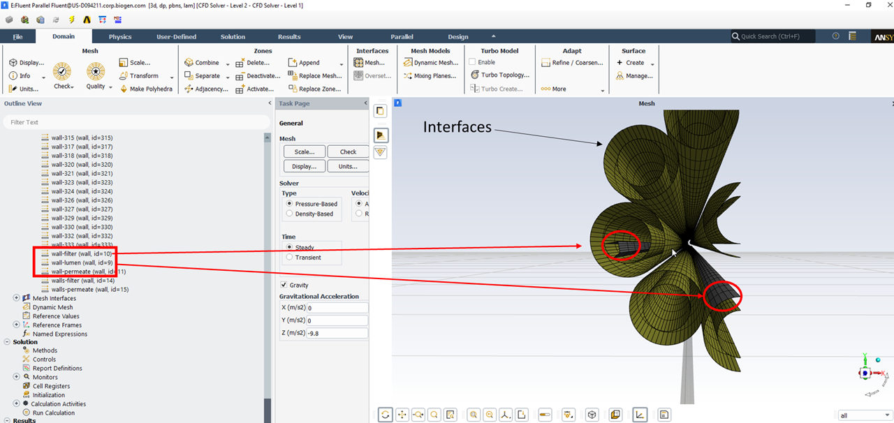

SubscriberI could fixed the Non-Positive Volume Cells and Interface Zones Overlap errors by improving the mesh, but I still have another issue! when I open Fluent, it generated shadow walls for each interface, which is fine. but it generates 4 walls, which seem not shadow, they seem like real walls! bellow is the figure :

August 13, 2021 at 6:31 pmhhayati
SubscriberI could fix this issue too. I explain it here in case anyone faces this issue in future.
There was a tiny gap between the blocks, and that gap generated those walls. I went back to Spaceclaim and fixed the gap and remeshed the model and the problem got fixed.
Another issue was because of the connections. Instead of selecting a face as the interface between two domains, it turned out that an edge was selected by mistake! and this caused the issue.
Hope this post is hopeful for others.
