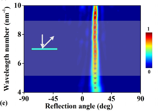

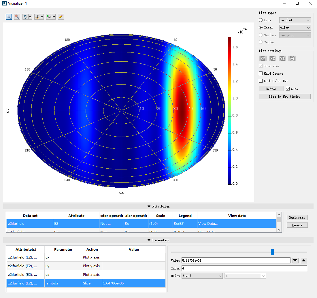

Guilin Sun
Ansys Employee???????????????????????Meta???,?????????????????????????:nAnsys Insight: ???????????n???Meta??,????farfield???????????????,????????:Ansys Insight: ?????????? n???????? ??????????????????? https://support.lumerical.com/hc/en-us/articles/360042097313-Metalens-Zemax-Interoperability
