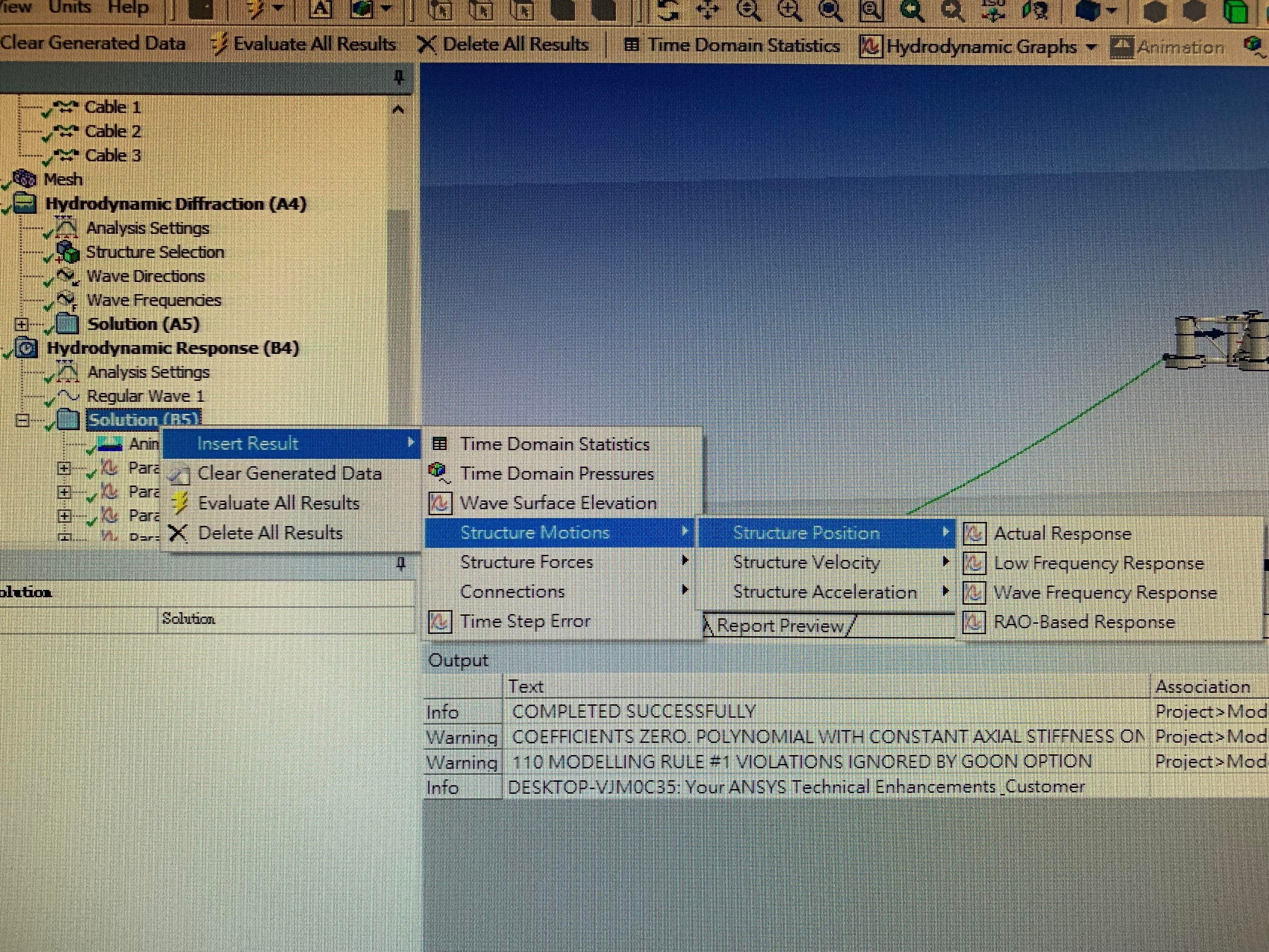

SubscriberI use AQWA to simulate a floating structure.
I want to check the 6 dof displacement(surge、sway、heave、roll、pitch、yaw) vs. times, which solution should I choose?
March 23, 2022 at 5:03 pmMike Pettit
You should choose Structure Motions > Structure Position > Actual Response to plot the total structure motion vs time.
Low Frequency Response is the Actual Response with a low-pass filter applied, to estimate the motion of the structure at lower (drift) frequencies; Wave Frequency Response is the high-frequency motion, calculated as the difference between the Actual Response and the Low Frequency Response. RAO-Based Response is the motion of the structure based on the linear RAOs only.
In the result input details select the Component from Global X, Global Y, Global Z for translational motions; or Global RX, Global RY, Global RZ for rotational motions.
Aqwa results are always reported in the global axes - 'surge', 'sway', etc do not really apply, as these refer to a local structure axis system.
I hope this helps!
Cheers, Mike
