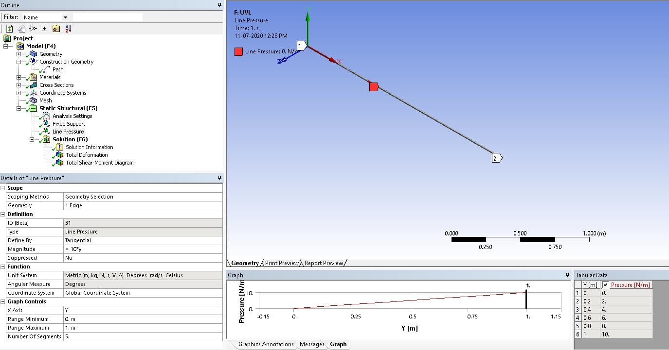

Do you mean a triangular shape? If the beam is along the X axis and the beam is of length L, and the load starts at P at x=0 and is 0 at x=L, is that what you want? If so, you can have a table or formula for load as a function of X. Just change the Independent variable from Time to X and you can define a spatially varying load.

1) My question is
I want to apply a load in a downward direction which is perpendicular to the axis of the beam or bar.

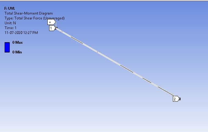

2) If I apply the UVL in the direction of X, we get the result in deformation
Load Applied
Deformation Result
Shear Force & Bending Moment Diagram
The value shows zero. Because load applied in Axial Direction.
So, If we change the load in Y or Z Direction. The result is not coming. Even deformation also shows zero
So Finally other than X Direction we cant able to apply load in other directions. Can you please check and give me the result.
July 11, 2020 at 11:06 am
peteroznewman
SubscriberThe tangential direction to a straight line is axial. You are applying an axial load, stretching the beam along the X direction.
As you noted in this post, you can't assign the Independent Variable to a coordinate direction for a Line Pressure when it is set to Components.
You will have to use Nodal Force to get a triangular shape of load. That is tedious because you have to make a Named Selection for each node and create a Nodal Force for each node.
