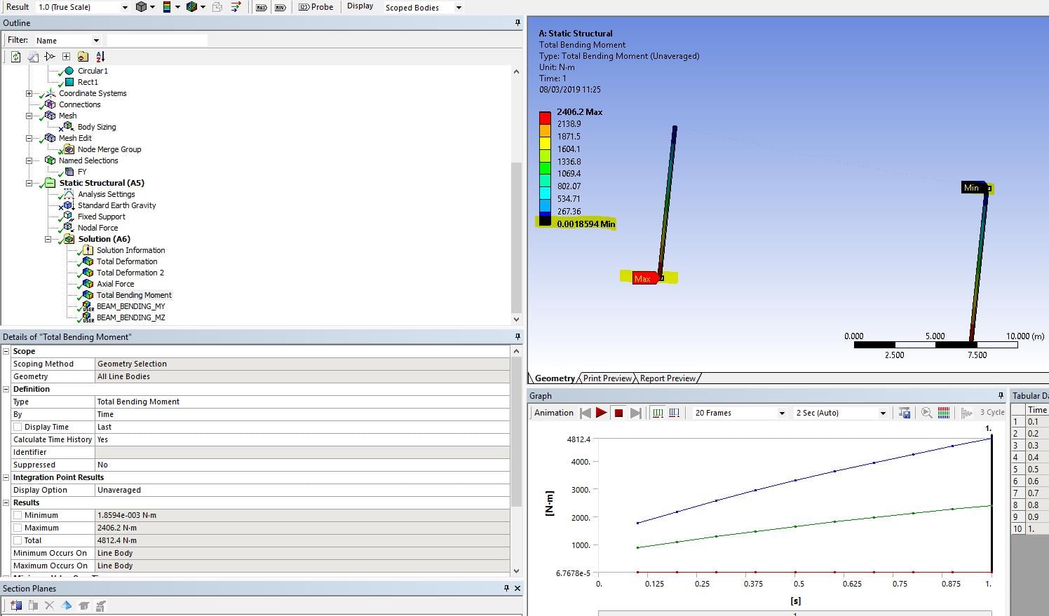

Link180 is a truss with no rotational dof, thus it should not do anything on the beam (apply moments), since it forms a natural hinge when connected to one .
2 columns, and 2 link180 representing a cable with a point load at the centre of the cable. As you can see it does not apply any moment on the top of the columns, and rotates like a hinge at their connections. Strand7 gives exactly the same results.Â
So there is no need to end release anything, they form a natural hinge.
