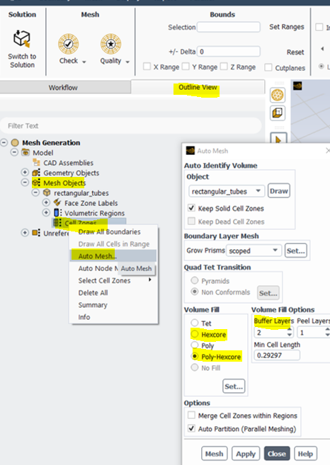

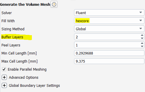

It seems like the Volume mesh task is not showing you the number of Buffer layers for cartesian-type mesh.
You can try to create the Volume mesh from the Outline view > Mesh Objects > Cell Zones > right click > Auto Mesh
