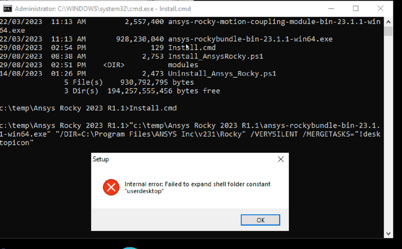

Hi
Thanks for the reply
I added the Path switch to the install string and looks like the mapped drive error has stopped popping up but I am still getting the the error Failed to expand shell folder userdesktop
I have added the suggestion from that thread but it hasnt worked
Here is my install string:
ansys-rockybundle-bin-23.1.1-win64.exe" "/DIR=C:\Program Files\ANSYS Inc\v231\Rocky" /VERYSILENT /MERGETASKS="!desktopicon"
Screenshot:
