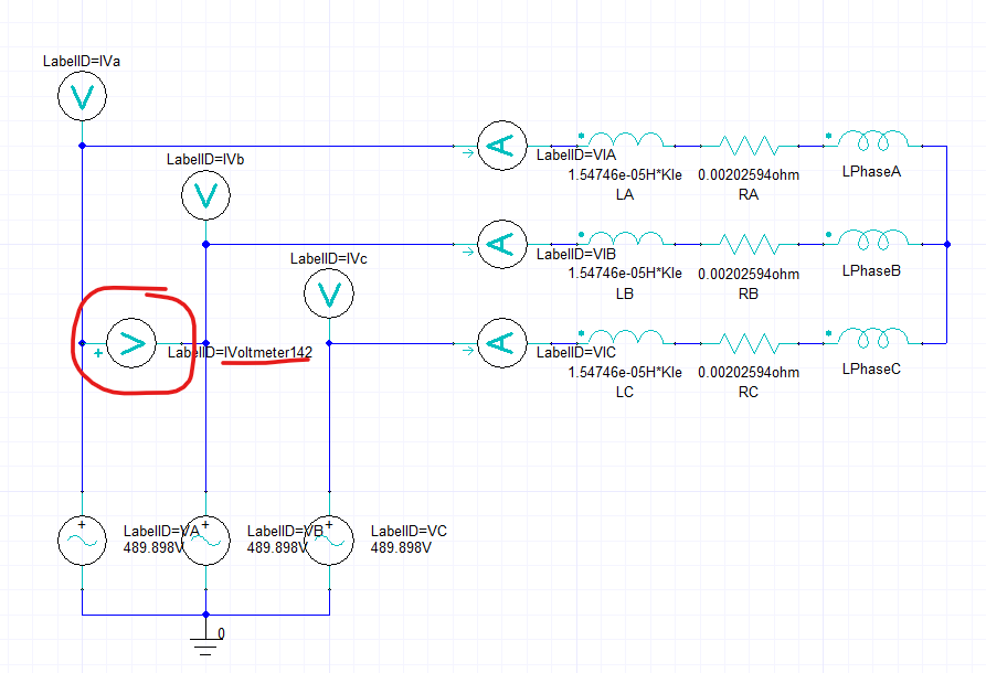

If I understand correctly you want to plot the readings of Voltmeter and Ammeter.
Once you imported the circuit netlist for the external circuit, they will be automatically available for you to plot in the rectangular plots.
For example, I have added an additional voltmeter as shown below.

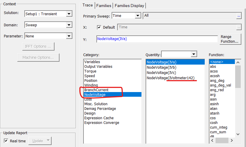

When I got to Results>Create transient report>Rectangular plot I can see the voltmeter under node voltages to plot
Look under node voltage and Branch current under Category.
