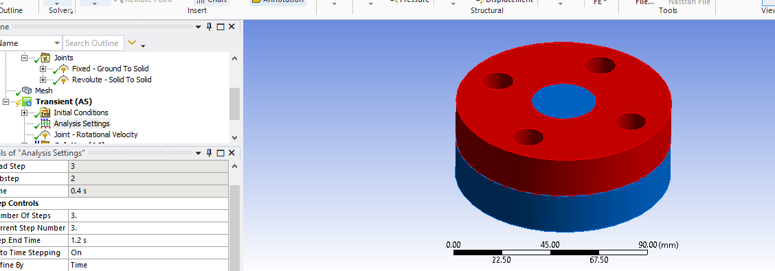

Here you see the model:

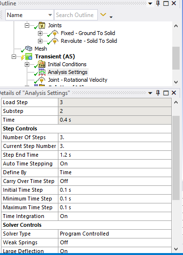

The analysis setting is here:
The force convergence plot could not be obtained because the Ansys cannot solve the current situation. To my odds, the same settings in a rigid dynamics environment give me results.
