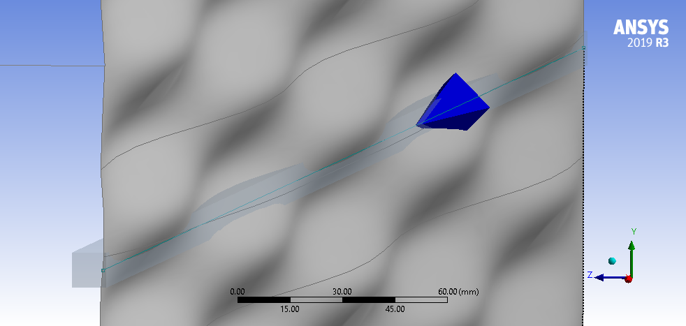

February 4, 2021 at 3:35 pmelhamasadi SubscriberFebruary 10, 2021 at 2:06 pmAniket Forum ModeratorTo answer your question 2 regarding the difference, what connection are you using when using line to shell body? it seems only the ends of the line body is connected to the surface body, it may help to use more elements in the line body along with MPC formulation for the contact between the line and shell body.nn-AniketnHow to access Ansys help linksnGuidelines for Posting on Ansys Learning ForumnViewing 1 reply thread- The topic ‘How can I define beam elements on a wavy surface?’ is closed to new replies.
