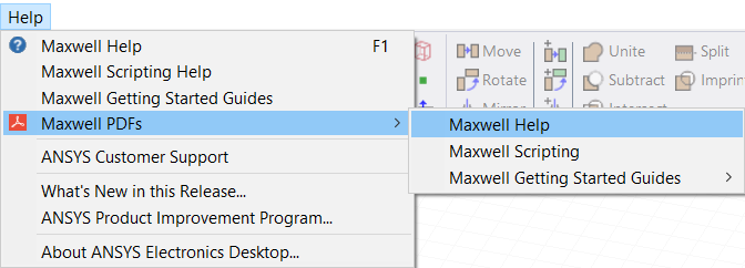

      Hi,nYou can model the Litz wire in Transient or Eddy current solversnYou can take the skin and proximity effects into account by modeling the wire as Litz wirenCreate a stranded excitationnIn the material properties for the coil change the composition to Litz and set the number of Litz strands as well as strands diameters.nPlease refer to maxwell help > Litz wire modeling section.nnRegards,nNavyan
