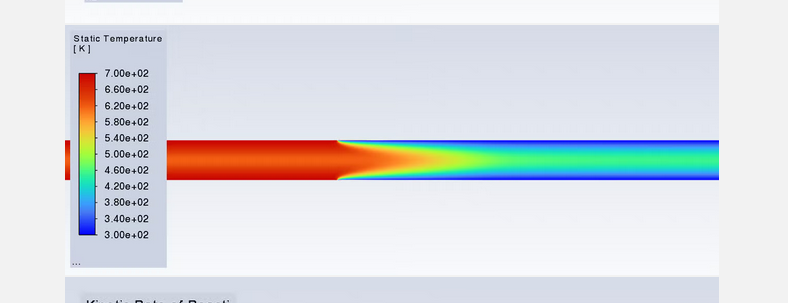

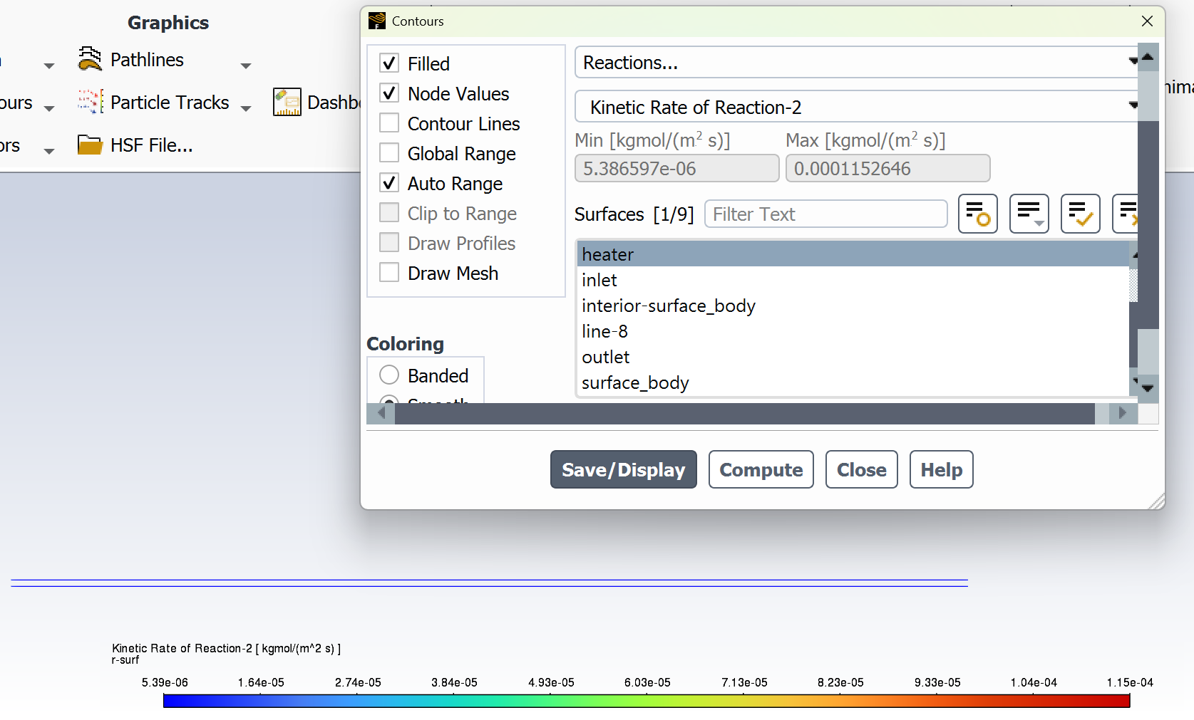

      The following contours, towards the end of the hot zone, are from a prematurely paused simulation when the hot walls are set to 700 K with the stainless steel catalyst enabled, which should cause a considerable surface reaction rate for both catalysts:
      As can be seen from the H2 mass fraction and surface reaction results, there is basically no surface reaction happening for either mechanism, even when I go up to 1000 K. For the ruthenium catalyst mechanism, I never had a problem up until this point until fairly recently. All I did recently was clean up the text files to make them easier on the eyes, and this is my first time using the stainless steel mechanism. There are no import errors for the mechanism, and the values of the kinetic parameters as they appear in the Reactions window in are good. Any help I can get would be greatly appreciated.

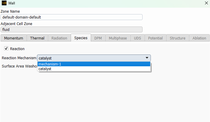

      To clarify - you were seeing hydrogen production in the same simulations before changing your mechanism for the Ruthenium simulations? Or is this the behavior you've been seeing all along?
      If the Arrhenius parameters look good in Fluent, my first thought would be to check the species tab for your wall boundary. Do you have the reaction/species info set up the way you want there?
    • abtharpe42

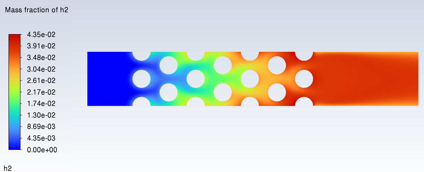

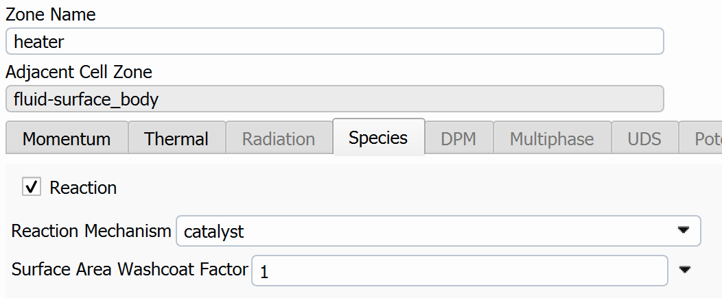

      Neither the stainless steel or ruthenium mechanisms are working with this specific simulation in that I am getting next to no H2 production with a wall temp of 1000 K. The only thing I do to enable the surface reaction on a wall BC is to check the Reaction box and select my catalyst in the dropdown menu. I've done a few FR/No TCI simulations with the ruthenium chemistry before and they've worked pretty well, albeit with pretty slow convergence. Yesterday I went back to an older 2D planar simulation that I've done with a turbulent NH3 flow traversing rows of circular pins (or circular cut-outs in the 2D plane), the edges of which were set to a constant temperature and had the surface reactions applied. At the time was testing to see how well the EDC-PaSR model works with surface reactions (it does work and way faster than FR/No TCI) since I was going to couple them to a combustion simulation of a gas turbine combustor that I'm working on. I retried that simulation from scratch with both the EDC-PaSR and FR/No TCI to see if I screwed something up with the ruthenium mechanism (haven't tried the stainless steel yet), and I did absolutely nothing different from before with the BCs. Lo-and-behold the simulation with the pins worked with both chemistry models. For whatever reason, it's this paper's scenario specifically that is not working at all.
    • abtharpe42
      For example with FR/No TCI with 1000 K walls:

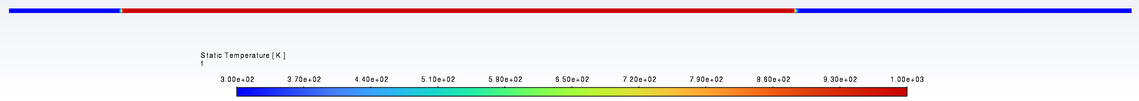

      I took your mechanism and loaded it up on a dummy case here. The first pothole can come up if you forget to set the wall mechanism to catalyst.  (It seems like you have done that, though, because your rates are small, but not totally zeroed.)

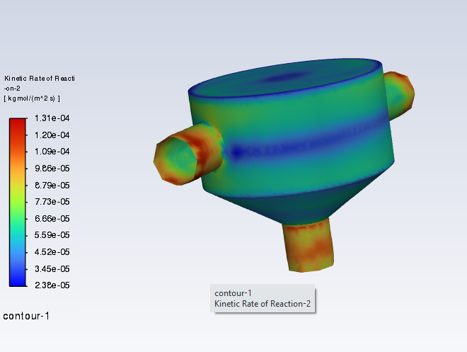

      Next we can look at boundary conditions. You mentioned you had set temperatures of up to 1000K:  Since the surface reaction uses wall temperature, increasing the gas temperature may have no impact if a low wall temperature is set.
      Here are my reaction rates for 1000 K wall temperature (300 K gas temperature):
      And for 300 K wall temperature with 1000 K gas temperature:
      So it seems there is something special about your scenario
      Judy
    • jcooper
      In this image, I am not seeing any signs of low wall temperatures upstream and high wall temperatures on the upstream… Is it possible that you have the boundary conditions reversed?

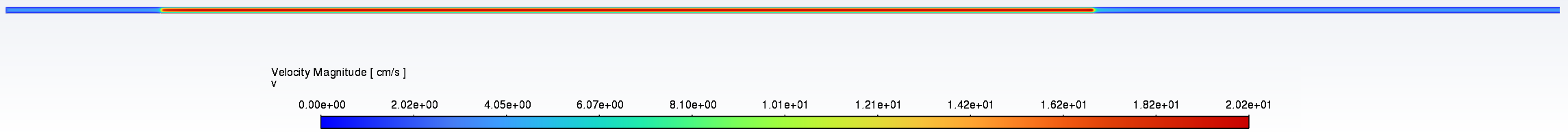

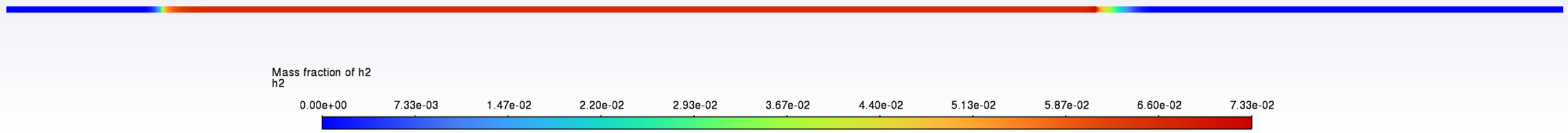

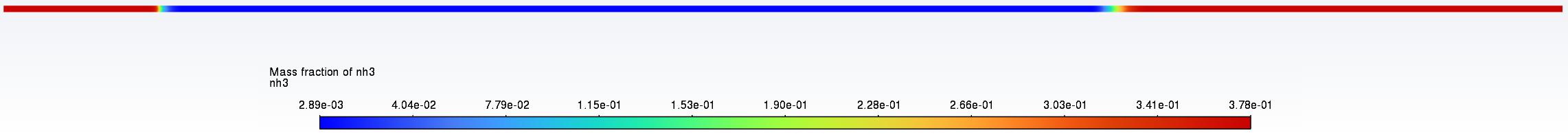

      I've gone back to my paper's scenario to double check to see if I screwed up the setup. Everything looks good. I had the simulation run overnight to see if I just wasn't giving it enough iterations, and I've just now seen how weird this thing is behaving. Here are some contours from the paper's scenerio, even though they're kinda hard to see because the geometry is a very thin and long pipe:
    • abtharpe42

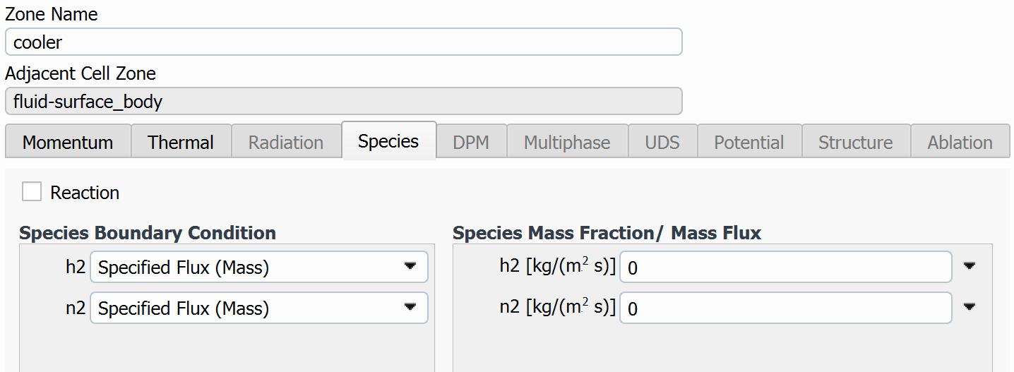

      It looks like the H2 is disappearing after the hot zone, which is crazy because there are no backwards reactions involved at all. Here is my species transport window:
    • jcooper
      What happens to your solution if you set Chemistry solver to Direct Source ? Does anything change? I wonder if the competing, essentially duplicate reactions (w.r.t species) are causing problems for the source linearizations imposed by Chemkin CFD... It may also be tricky for the numerics to deal with the sudden shift in wall temperature..  Are you doing anything with the mesh, like refining in the axial direction, to help the solver cope with this?
