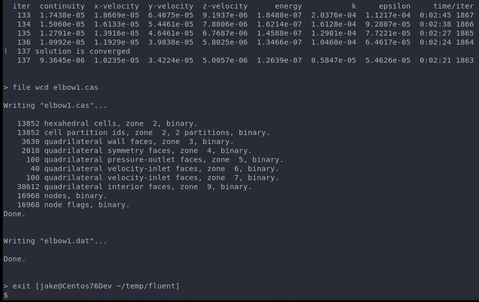

Ok, I have put together a package for you.
https://drive.google.com/open?id=1Yi4nHugidwWKEujbtgPNwjbBcZZ-o5pG
Untar it in a location that is shared across nodes.
then to run it, cd to the directory where the .cas and .jou files are, and run:
/ansys_inc/v193/fluent/bin/fluent 3d -g -t2 -i elbow1-rel-path-no-dat.jouÂ
Adjust paths as necessary.
That will run it on two cores on the machine you are logged into.
Lets see if that works first.
If it completes without issue you should see something like:
Thank you,
Jake
