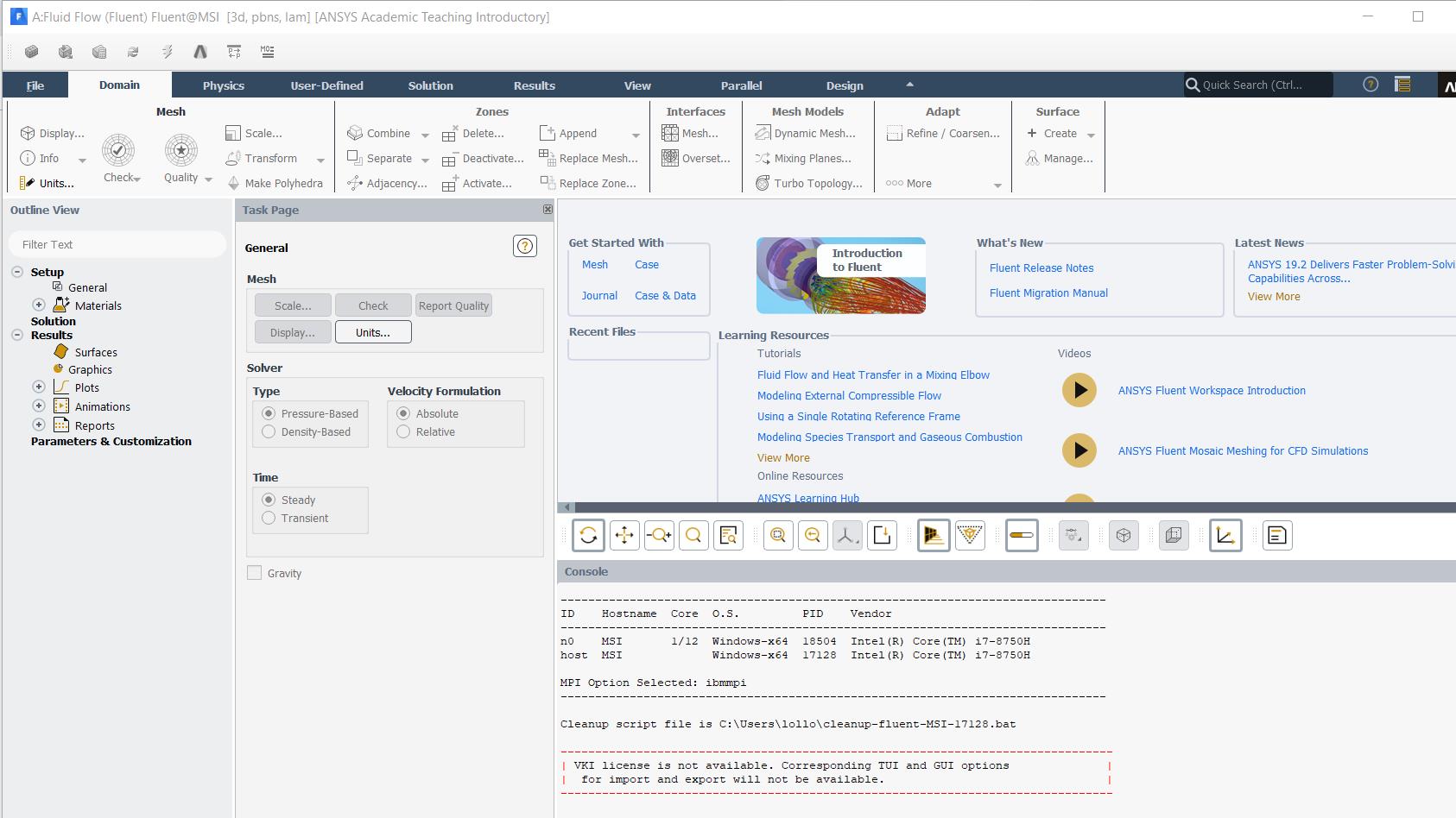

SubscriberIs there any solution to this problem? I've recently installed whole ANSYS package and Fluent has been working just fine until this notification popped out and some options have been blocked like drawing contours, which is crucial to my work. To be precise, in my case only this pops out "VKI license is not available. Corresponding TUI and GUI options for import and export will not be available".

Forum ModeratorYes, I posted it last week: does it actually effect anything that you're trying to do?
