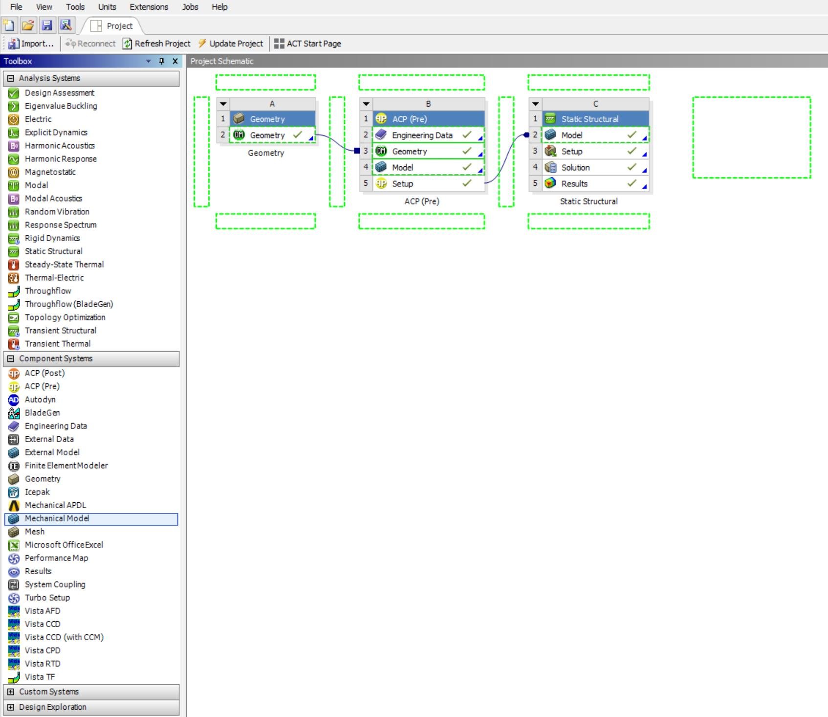

SubscriberIn the toolbox, below the Analysis Systems are the Component Systems. Drag a Mechanical Model out and drop it on the ACP (Pre) Setup cell.

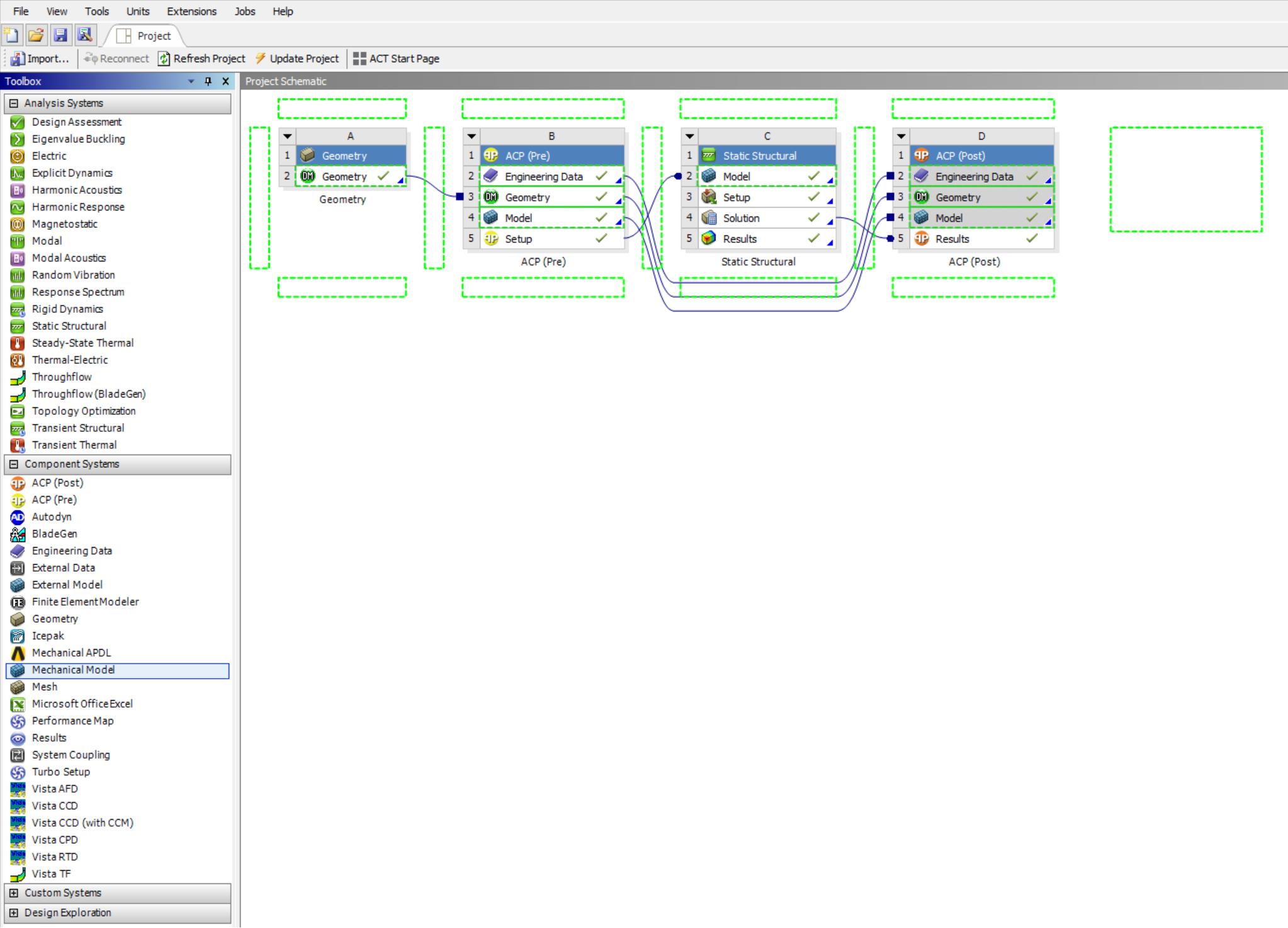

Ansys EmployeeHi Marin,
Please try drag "Static Structural" instead of "Mechanical Model" from to the tool box and put it on top of ACP.
April
November 14, 2018 at 12:39 am
Marvin
SubscriberYes, thank You April! It does work, only the Static Struct. must be dragged on top of the Model cell of existing Static Structural.
