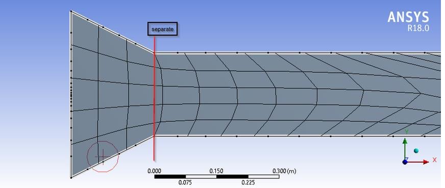

    • raul.raghav
      You can separate the geometry into two parts at the location (shown below in the image) and "Form a New Part" in design modeler. Then open your meshing and continue the Face Meshing + Edge Sizing.

    • omareg94
      Thanks a lot Rahul for your precious help.
      I'm now able to get this
    • raul.raghav
      Refer to the following image and make slices as shown. You'll have a very uniform quadrilateral mesh if you slice your geometry this way. Good luck!
