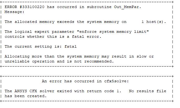

January 20, 2019 at 1:50 pm
January 21, 2019 at 12:49 am
raul.raghav
SubscriberYou would have reduce the number of nodes on your mesh or increase your system RAM. Can you provide information on the number of mesh elements you have and the size of your system RAMÂ
January 21, 2019 at 8:52 am
gongpop
SubscriberNumber of Elements is 44113880 and ram size is 16GB
