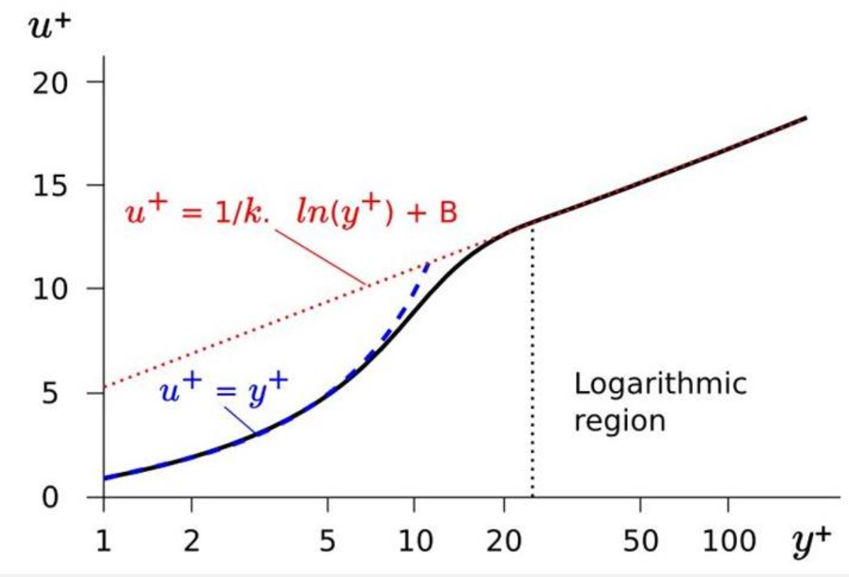

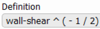

      I am doing a project related to turbulent flow boundary layers. I am attempting to calculate u+ so that I can make a plot of u+ vs. log(y+) along a line normal to a nozzle wall.

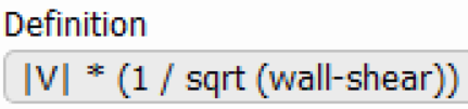

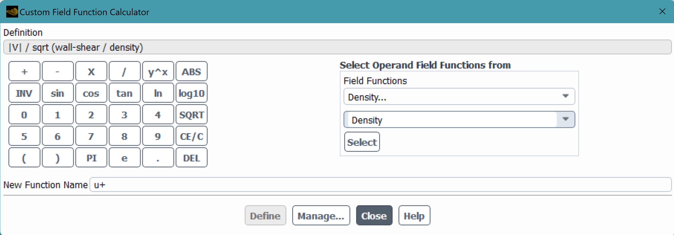

      I have defined u+ in the following way:

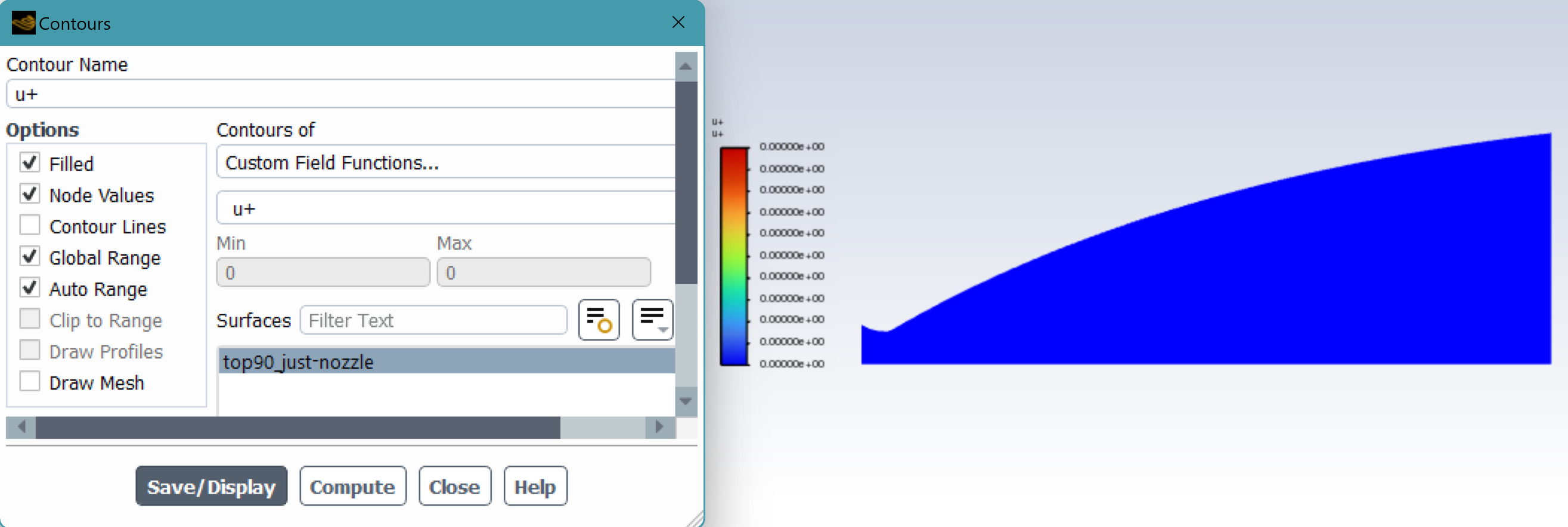

      However, a contour plot of u+ in my domain shows that u+ is zero everywhere.

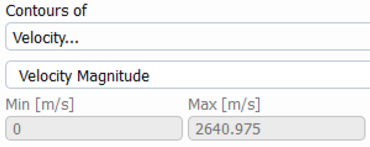

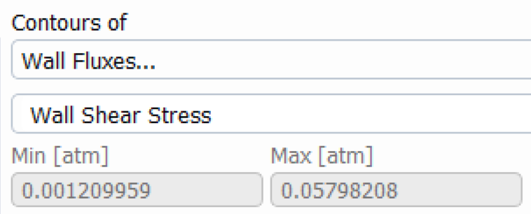

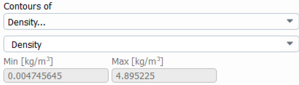

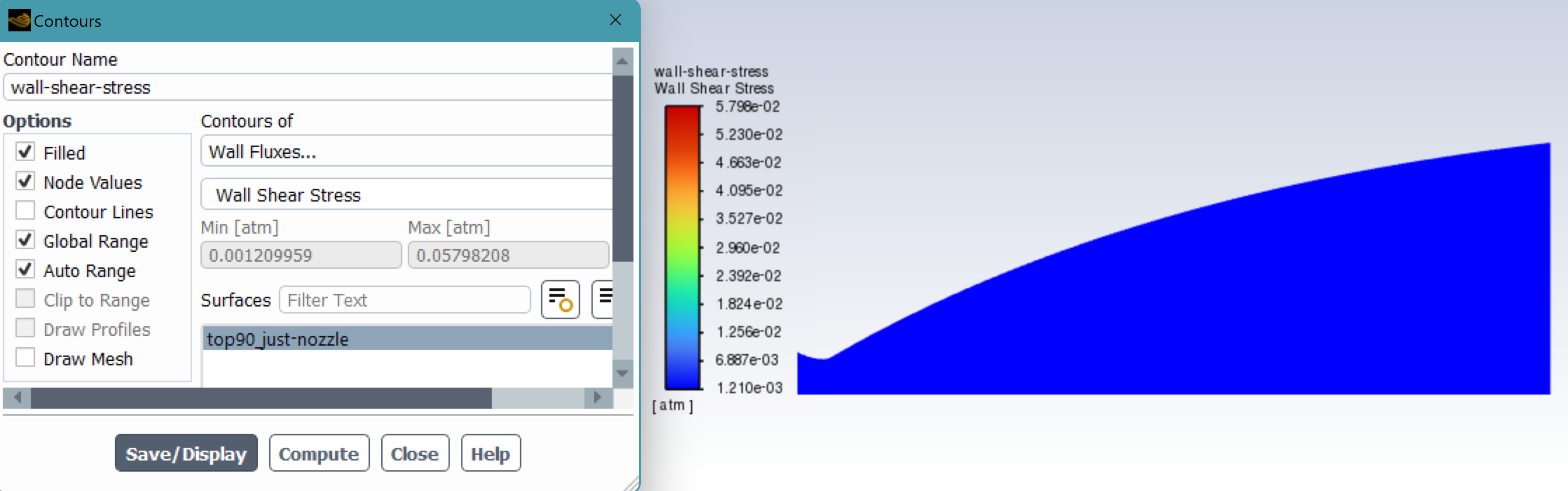

      I suspected that perhaps either the velocity magnitude, wall shear stress, or density are also zero everywhere, but that is not the case:
      Interestingly, the following custom field functions also resulted in a contour of zero everywhere:
      And, the following custom field function resulted in nan everywhere.
      Clearly there is something going wrong in the custom field functions when "wall-shear" is involved. However, as mentioned above, the wall shear stress itself is NOT zero anywhere.

      Wall shear is technically zero on your contour as it's calculated on the wall. You're displaying on the fluid domain.
    • SRP
      Try to create custom function for u_tau then u/u_tau.
