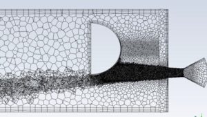

This course will help you understand how to simulate and capture bulk evaporation of water under the influence of a localized wall heat flux using Ansys Fluent® fluid simulation software. The resulting vapor plume flow exhibits dispersed bubbly nature, and we will evaluate the overall steam quality at the outlet.
In this course, you will choose the Mixture Multiphase Model for the two-phase flow analysis with the Evaporation-Condensation (Lee Model) capturing the mass transfer process.
