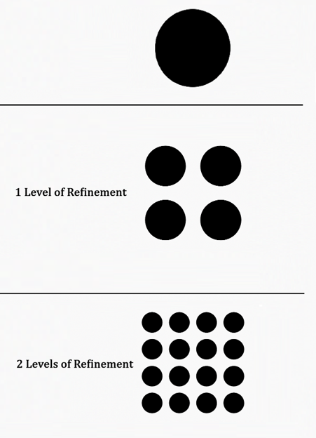

A refinement zone is computed as:Refinement Distance = Refinement Distance Factor × Initial SPH Size
All SPH elements within this distance from the selected geometry are refined. The refinement region is subdivided into volumes proportional to its size, with refinement levels that increase gradually across these partitions. The figure below provides a schematic representation of this process.2. Cubic Region of Interest (ROI)
