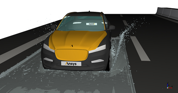

      Criteria 1: SPH elements
      To assess the performance of a Ansys FreeFlow we use a vehicle driving through a water puddle (car wading). The fluid is model using 16 millions of SPH elements and all geometries have about a total of 32 million triangles.
      Figure 1 – Car wading simulation.

      Figure 2 shows the performance speed-up for the IISPH solver in Ansys FreeFlow. It is worth to mention that FreeFlow has another two other solvers WCSPH and DFSPH (Beta).
      • The results show a huge performance gain of running a SPH simulation in a GPU. In the worst-case scenario, compared to a run in 48 CPU cores, you can reduce your simulation pace with one GPU in 23 times, approximately.
      • The multi-GPU results also highlight the benefits of running SPH in a graphic card, with two GPUs you can achieve a time reduction about 65 times compared with a 48 CPU cores.
      Figure 2 – GPU speed-up based upon Simulation Pace (compared with CPU 48x cores) achieved for the car wading.
