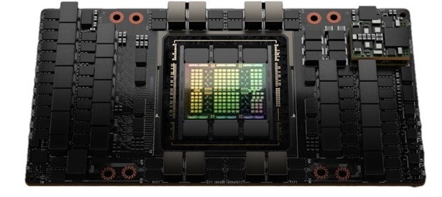

      Figure 1.  Nvidia H100 GPU internals

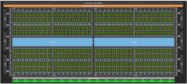

      Figure 2.  Nvidia H100 SM layout
      All the small green squares are SMs.  Slightly different number of SMs depending on the variant. H100 PCIe (114 SMs), H100 SXM5, (132 SMs), GH100 (144 SMs).  The Grace Hopper architecture co-locates ARM CPUs with the GPUs on the card.

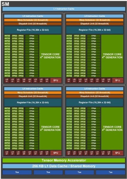

      Figure 3.  Nvidia H100 SM internals showing different types of cores.  Note the FP64 cores for native double precision calculations
      When Double Precision is Required
      High-end GPUs, such as the NVIDIA H100, include dedicated FP64 cores, enabling fast and efficient double-precision calculations. In contrast, lower end GPU cards emulate FP64 by combining two FP32 (single precision) cores, which significantly reduces performance for double-precision workloads.  When native FP64 cores are present, as in the H100, this emulation is unnecessary, resulting in substantially better performance. Additionally, the H100 delivers higher FP32 performance and greater memory bandwidth, making it faster even for single-precision workloads.
      [Reference comparison:  https://vast.ai/article/nvidia-h100-vs-l40s-power-meets-versatility]
      Most interesting, the H100 GPUs have no RT cores. Ansys optics simulations, which benefit from RT cores are still fast on H100 GPUs, but cost efficiency is much better on L40 hardware which has 142 RT cores.

      What are streaming multiprocessors (SMs) and compute units (CUs)?
      A SM or CU is a fundamental component of a GPU card, with nomenclature that is vendor dependent. NVIDIA GPUs are comprised of streaming SMs that contain CUDA cores, and AMD GPUs are comprised of CUs that contain stream processors. A SM/CU is a collection of processing units that work together to execute command kernels (CUDA for NVIDIA, HIP for AMD). Each SM/CU consists of several smaller cores, which are responsible for executing parallel computations and performing tasks related to rendering and other general-purpose computing.
      The number of SMs/CUs in a GPU depends on the specific model and architecture. For example, the NVIDIA GeForce RTX 3080 has 68 SMs, while the NVIDIA Tesla V100 has 80 SMs. Similarly, the AMD MI210 contains 104 CUs. More powerful GPU cards typically contain more SMs/CUs.
