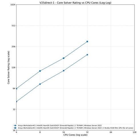

The following benchmark comparison illustrates how GPUs can perform in Mechanical APDL workloads (Benchmark Mechanical Information | Ansys). For this direct solver benchmark model in the V25 set, an Nvidia H100 GPU provides consistent acceleration compared to running with only CPU cores.

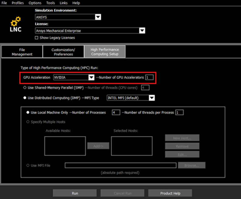

- Activate the GPU acceleration option through either of the two methods:
- In the Mechanical APDL Product Launcher, select the High-Performance Computing Setup tab, choose the appropriate GPU Acceleration option from the dropdown, and specify the number of GPUs to use during the solution.
Figure 4: Activate GPU acceleration through the Product Launcher
- Or, as a command line argument.
For example, with one NVIDIA GPU: ansys252 -acc nvidia -na 1
Or with two AMD GPUs (Linux only): ansys252 -acc amd -na 2
