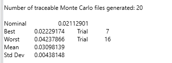

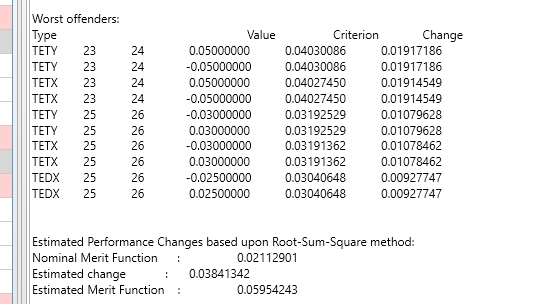

      In my tolerance report, in the Sensitivity Analysis and the Monte Carlo simulation, I am getting two things: My WFE value from the RWCE operand as expected when using the REPORT command in my script, and also the "Nominal Criterion" which is the literal merit function value since I am using a user-defined script. For me, the WFE is the actual useful thing for real life assessment of the system.
      Here is my question: It is well and good that my report lists the WFE for each tolerance extreme in the Sensitivity analysis and each Monte Carlo output because I can read it manually and make sure I am within my performance constraints. However, what I really want is the summaries (see two screenshots) for the Sensivity analysis and the Monte Carlo analysis to be in WFE, not merit function value.

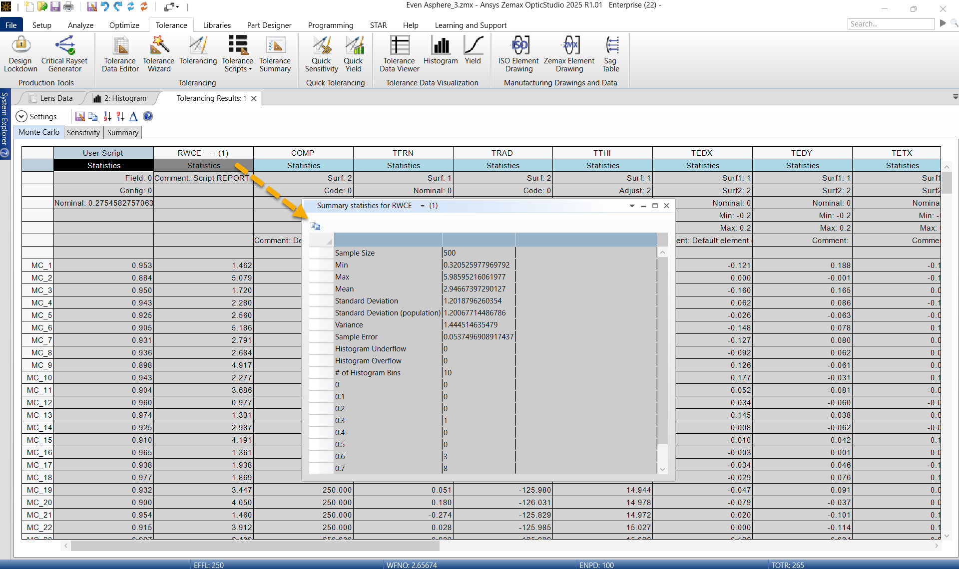

      For the Monte Carlo statistics, you can actually click on the "Statistics" cell of any column, and access the needed information:

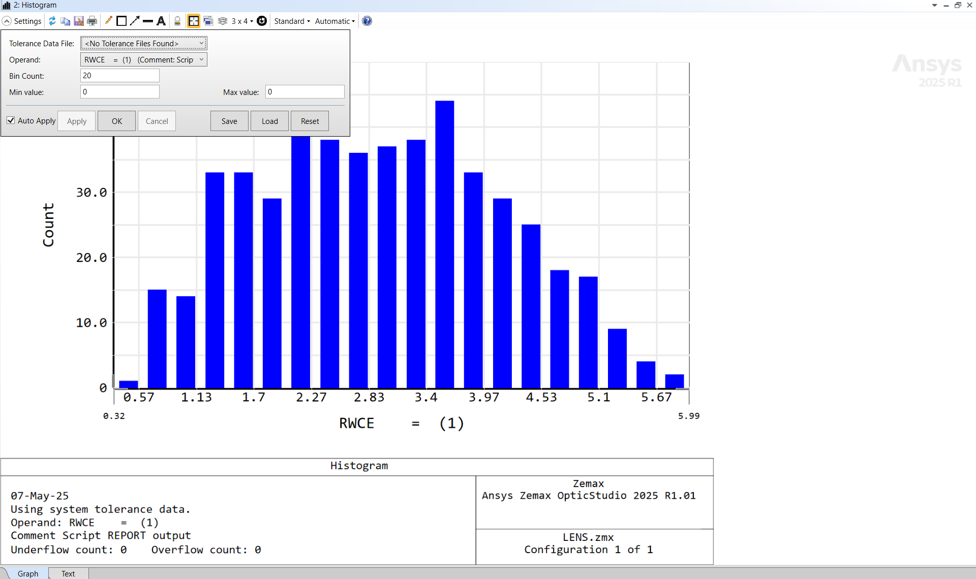

      With the histogram tool, you may also have a visual feedback of any tolerance operand, merit function or reported merit function operand:

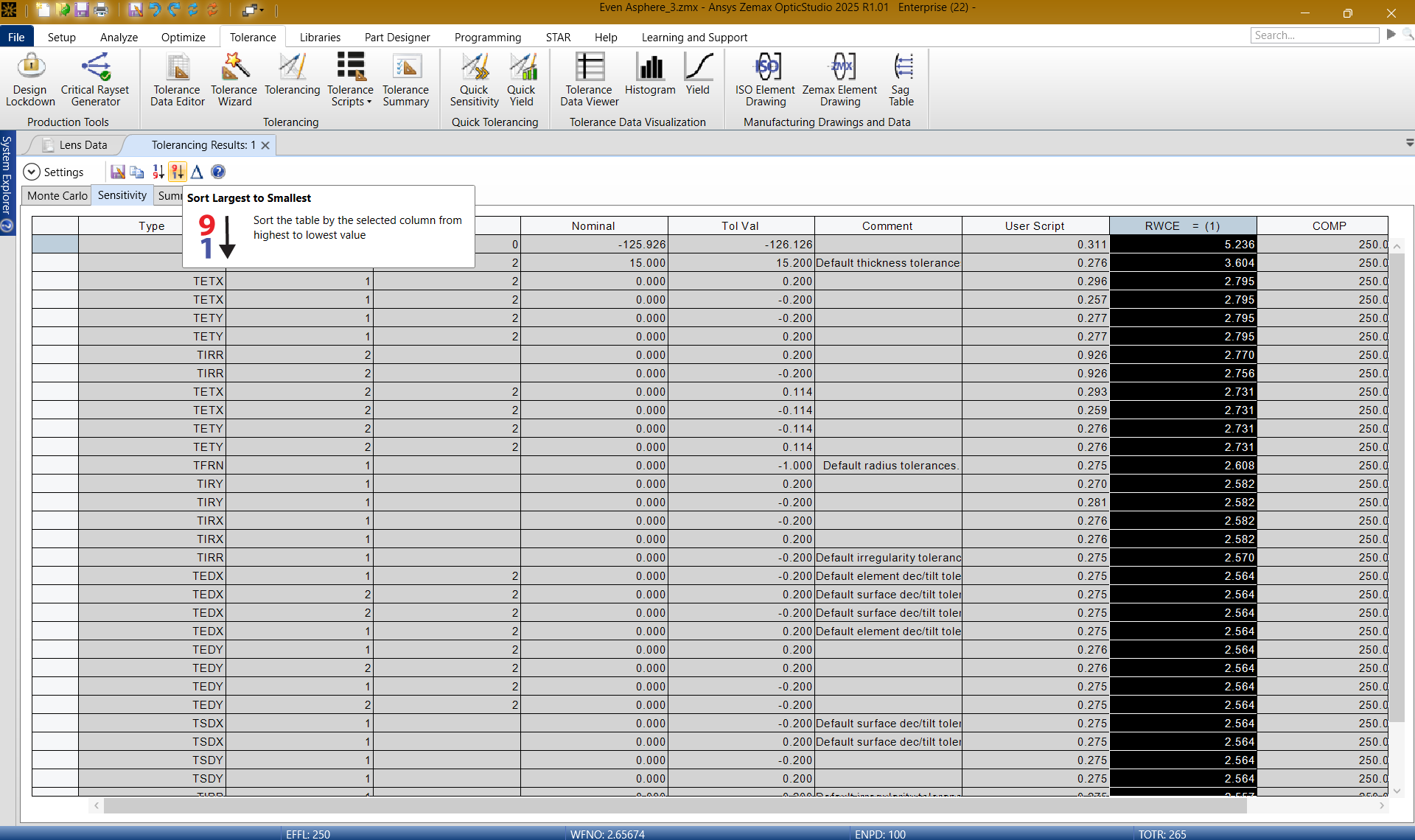

      For the worst offenders, you can sort the tolerance results in any order, for any column of your choice:
      Does this looks OK for you ?
