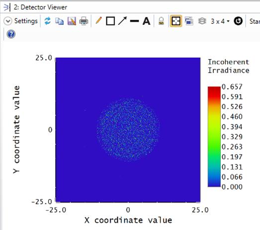

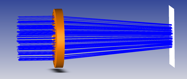

      Example of the simulation I wish to conduct:
      Ray tracing simulation of the fresnel lens
      Performance analysis of the fresnel lens.

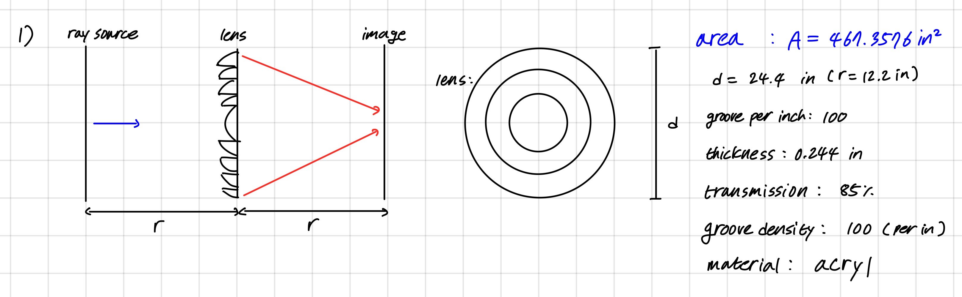

      My desired simulations are separated into two parts: Part 1) Whole Lens Analysis and Part 2) Sectioned Lens Analysis
      Objective: Detect the rays at the focal point.
      The specifics of my simulation is as follows:
      Lens:
      Fresnel lens diameter (inch): 24.4
      Lens thickness (inch): 0.244
      Groove per inch of the lens: 100
       Transmission(%): 85
      Lens Material: Acryl
      Setup:
      Ray source & Lens distance (in): 12.2
      Lens & Image(Ray detector) distance (in): 12.2
      Ray: Total 100,000 uniformly distributed rays
      I also attached an image regarding the simulation.

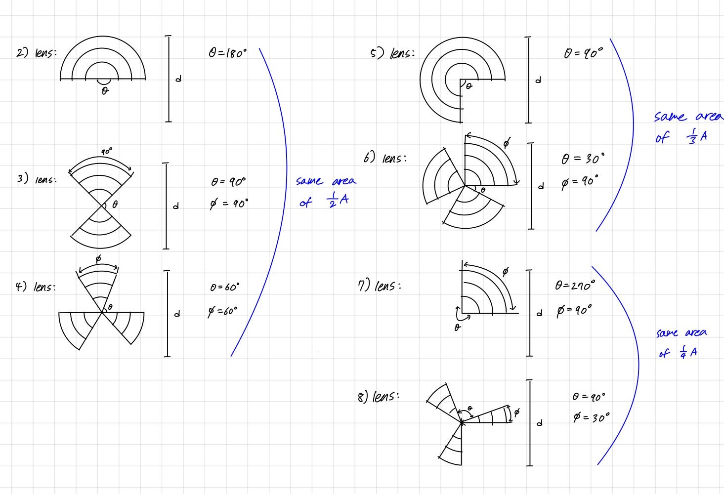

      After this simulation, I'm planning on varying the lens area(by cutting the lens into circular sectors of different angles) and conduct the simulation again.
      The plan is 'to create initial fresnel lens from the Part 1 above -> export the lens to SOLIDWORKS -> modify the lens into desired sections -> import the modified lens back into Zemax -> conduct simulation'.
      Objective: Detect the rays at the focal point for each variation of the fresnel lens.
      Setup: The setup is identical to Part 1 above.

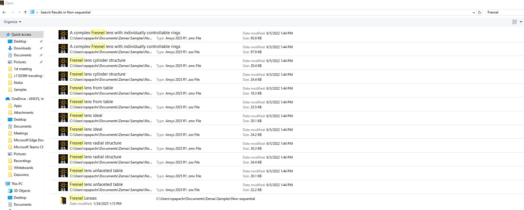

      Additionally, I would highly suggest to go through our Knowledge base articles: Zemax Knowledgebase there several articles that can hlp you create your design and specifically for the Fresnel lenses I would suggest this one: How to model a Fresnel lens in OpticStudio
      Finally, you can also check the sample files within Zemax installation folder (..\..\..\Documents\Zemax\Samples): if you search within the non-sequential folder "fresnel", you will be able to find several example files:
      Good luck with your desing and feel free to come back with any additional questions.
