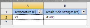

      I am running a structural simulation and one of the materials is Indium. As I check its mechanical properties, I found that its yield strength is higher than tensile strength. Can anyone explain why?

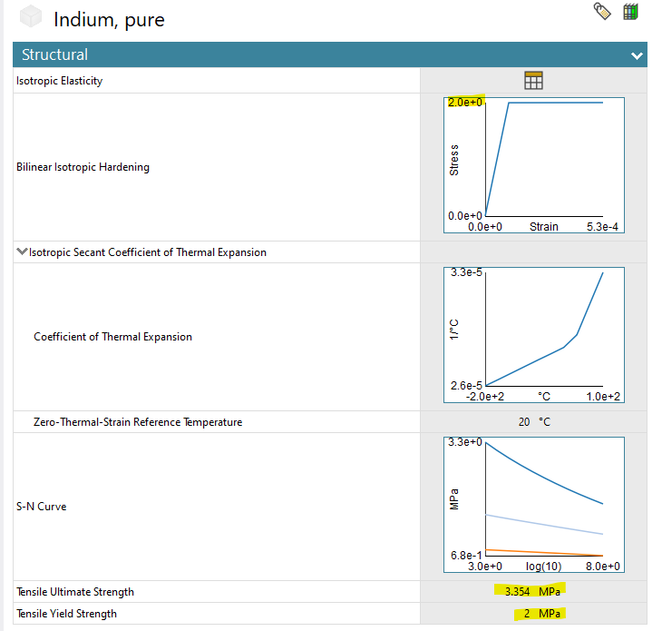

    • Sean Harvey
      Hello Azarandi,
      Here is what I see from inside Mechanical. Yield = 2MPa, Ultimate = 3.354 MPa.  WHere are you seeing tensile strength lower than 2MPa?
      Thanks,
      Sean
    • azarandi
      Hi Sean,
      As I showed in the table for Young's modulus, the Yield strength is higher than tensile strength. Is it right to say "due to the fact that little strain is needed to deform indium, it results in the very small elastic range with a proportionally steep slope?"

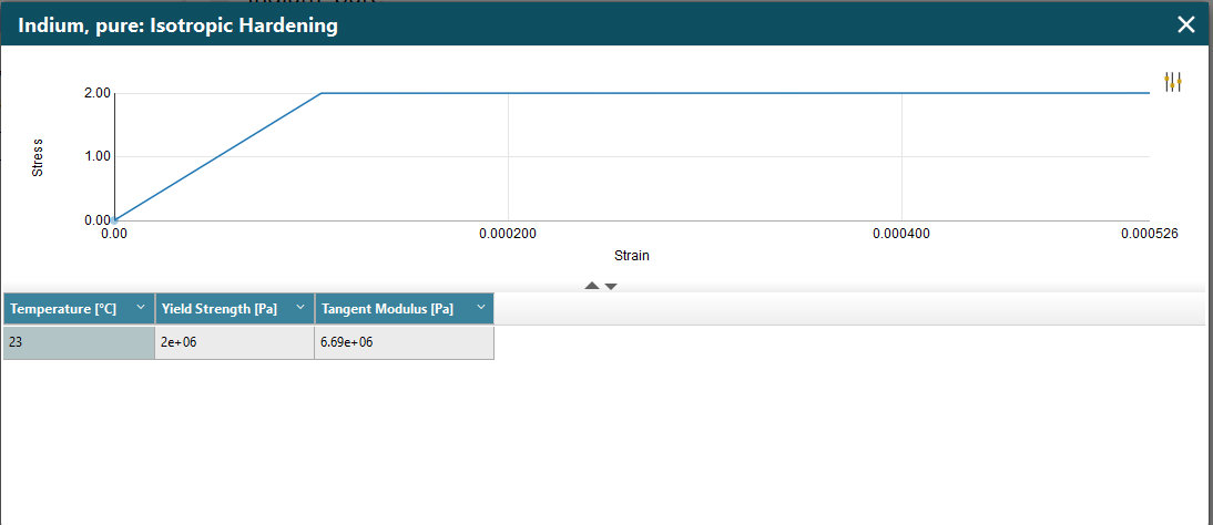

    • Sean Harvey
      Hello Azarandi,
      Just to clarify in column B that is Young's Modulus, not Tensile Strength, so it is the slope. Maybe you meant Tensile Modulus in your statement? But yes.  The strain to reach yield is tiny. 2.72E-04   So the elastic range is very very small.
