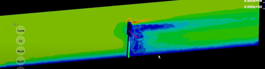

      Hi Rob, thank you!   I have one more quick question that may seem a little silly.    I am mostly a structural person and I've only really done CFD projects focused on conjugate heat transfer and for FSI.  I really appreciate your understanding.
      For the FSI case, when looking at static pressure on a wall perpendicular to the flow direction (see image below), what Y+ value should I even target?  I understand this depends on the turbulence model I want to use as well.   My goal is to get accurate pressure calculation on these walls to get the correct forces to be transmitted to the FEA side.
      If you're wanting a very accurate result aim for y+ = 1  as that's generally a good sign you've fully resolved the boundary layer gradients. If you have a y+ > 30 then you're using wall functions, they're still accurate but not quite as accurate. It's the same for heat transfer, with y+ = 1 being slightly more important.  Don't forget to resolve the flow separation and wake as that may also affect the result on the wall: the suction behind the wall may be important too. You may want to look up Ferrybridge (UK) power station in 1965 as cooling towers blew over due to dynamic wind effects.
