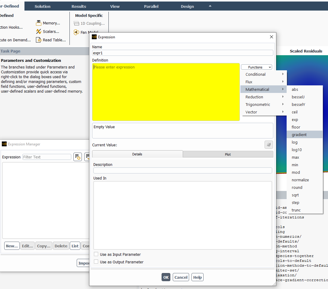

October 24, 2023 at 4:48 pm
Ramesh Chandra Mishra
SubscriberThis is what I am talking about. But I have a bit problem with this . It's syntax is Gradient
but how to know if it is gradient wrt to x, y or z. Secondly, can you guide me a bit towards UDF. As far as i know, concentration can be obtained by multiplying mass fraction with density. Not so sure about concentration gradient though. Can you help me proceed in this regard?
October 24, 2023 at 5:01 pm
Rob
Forum ModeratorConcentration is equivalent to volume fraction, and mass fraction is available so you may need to do some maths to convert.Â
October 24, 2023 at 5:36 pm
SubscriberThat part is fine by me but suppose I get the concentration, how do I convert it to gradient is my question. I can see macros for temperature and pressure gradient in the manual but could not find one for concentration gradient.
October 25, 2023 at 7:02 am
SubscriberIs it possible to get the gradient of a variable created in the udf?
October 25, 2023 at 8:05 am
Rob
Forum ModeratorCheck the User Defined Memory (UDM) macros - https://ansyshelp.ansys.com/account/Secured?returnurl=/Views/Secured/corp/v232/en/flu_udf/flu_udf_DataAccessMacros.html%23flu_udf_example_udm_uds_usage
