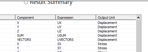

I cannot find there only one thing. What is the difference between UX and UALLX , UY and UALLY , USUM and UALLSUM ?
I know what is the definition of UX but how about UALLX and this kind of results? They are presented on the end of Available Solution Quantities table.

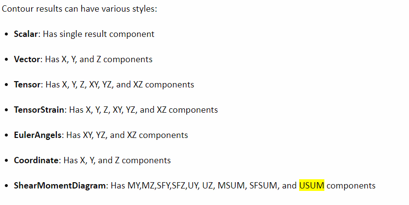

SubscriberHi Ciema The differences relate to the quantification of the component as shown in the snippet.
The answers will be in the ansys help. For example for contour results they may come in three types as nodal, elemental or elemental nodal. They then have various styles as shown below, i have also attached the link to this page.
https://ansyshelp.ansys.com/account/secured?returnurl=/Views/Secured/corp/v212/en/act_script/mech_apis_Contour_Results.html?q=USUM

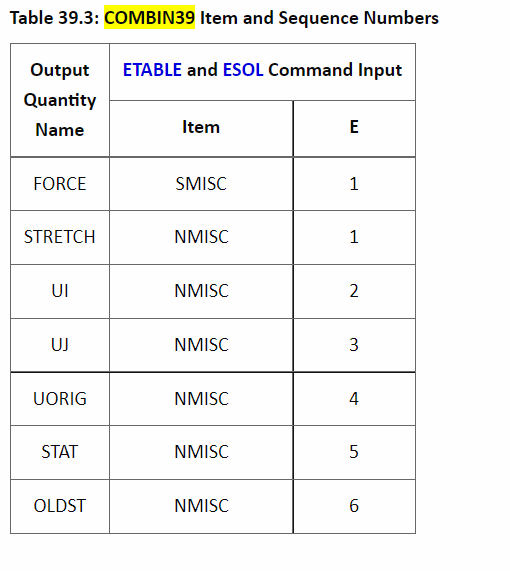

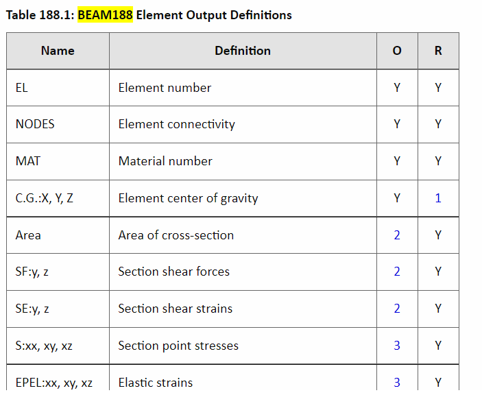

There are separate results depending on what elements have been used in your model. If you are using BEAM188 refer to this in the help section and you get a list of element outputs.
Similar if you are using a COMBIN39 element you can use the expressions provided in the table below to create your own User Defined Results.
