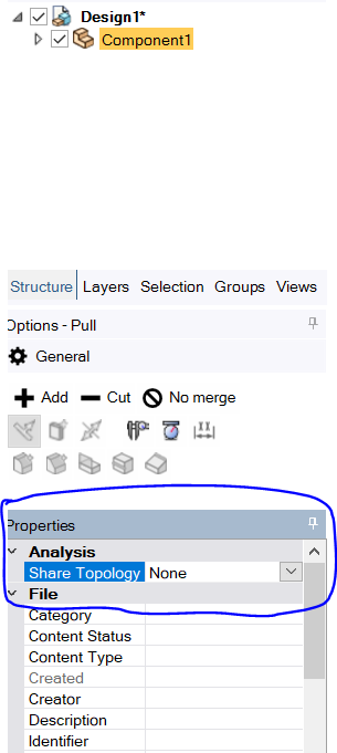

      "transfer all of the bodies into a new Component, and then under the Analysis option, I will see the Share Topology option"
      I can't find Analysis option, please show a screen snapshot.

      ,here you go.
      Years ago, the Analysis setting was the only way to create Shared Topology in SpaceClaim. Unfortunately, there was no feedback on what you would get until you meshed the bodies in Mechanical.
      When ANSYS introduced the Workbench Ribbon with the Share button, I stopped using the Analysis Share feature. The reason is the Workbench Share button provides better feedback and control. First there is the coincidence tolerance. Secondly there is the graphical feedback that shows you what will be shared and a button to let you exclude certain face pairs that you don't want to mesh across.
      All bodies that you want to share should be in the same component or at least the same subassembly. I frequently select a set of bodies on the screen, then Move to New Component, open that new component and click the Share button on the Workbench ribbon. This is useful if you want to idealize a chamber with a cover that has many nuts, bolts and washers holding them together. Just put the chamber and cover in a new component and leave all the hardware behind to delete or suppress for physics, since the hardware is not needed after you share topology to fasten the cover to the chamber.
