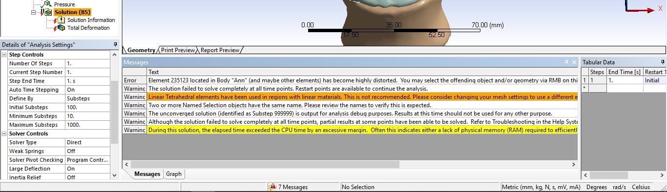

      I ran a static structural simulation by applying 100 MPa pressure to measure the models Total Deformation and Strain. It gave me the following error and 2 warning messages. Whereas, when I ran the simulation on same model with 10 MPa, I didnt get any errors.
      Hence, with these messages, can I consider that the model is incapable of bearing 100 MPa? or does this mean any other? How to solve?
      P. Mohankumar.

      Hello Mohankumar,
      This error does not mean the structure that solved with 10 MPa cannot support 100 MPa. It just means the solver failed to apply the full load without incurring an error.
      Please provide more details about your model, the geometry, the supports, the loads, the materials, the contacts, and we can help get the solution up to 100 MPa of pressure. Show us the Solution Information Force Convergence plot.
      Is there nonlinear contact in your model?  The error you show is sometimes seen when a contact fails to be established and one part passes through another part. Is this error on the first substep of your model?  If there is contact, did you use the Contact Tool to check initial contact status?
      What other nonlinear behaviors are in your model, do you have plasticity in your material model?  Did you turn on Large Deflection?  Are you using more than one Step?
      If you create a Workbench Project Archive .wbpz file, you can attach that to your reply. I can open your model and see what you need to do to fix it.
      Peter

      I am running a Static Linear analysis in Ansys 17.2 (Academic Research). The model was created using Materialise software with Tet4 elements and mesh size of 2mm. I want to apply pressure at one end of the bone and check how much pressure is received by the disc. Material properties are mentioned in the wbpz file. The initial contact tool showed no gap in the model. Whereas, after adding a manual contact point between 2 bones, it showed a gap. Actually, it is not supposed to be in contact but may happen while applying moment (rotation).
      I haven't turned on Large Deflection and no sub steps.
      *Note: I am a medical student running simulations for my research. Hence I request you to give me your feedback or suggestions in simple terms so that I can understand!!
      Regards.

      Hello Mohankumar,
      Here is a view of what happened in your solution that failed to converge:
      The solver tried to apply the full load (Time = 1) and did some iterations to find force balance and failed, cut the load in half (Bisection Occurred) and tried again, failed, cut the load in half again, failed, cut the load in half again to 1/8 the full load and failed then gave up.
      For the next try, you need to tell the solver to start with 1/100 of the full load and see if it can converge at least once. You do that by setting Auto Time Stepping On and setting the Initial Substeps to 100. (See next image).
      To see where it failed, you have to type a non zero integer into the Newton-Raphson Residual Plot. The maximum value in that plot is the location in the model where the largest force imbalance exists. The corrective action is usually to apply Mesh controls to reduce the element size.
      You should turn on Large Deflection for models where the displacement is going to involve significant changes in shape of the elements.
      After those changes, I ran the model and it failed again.
      But now I know where it had problems.  Five of the six requested plots show the problem is on the disk.
      Here is a zoomed in view of a slice through that point of the elements.
      Here is the residual force plot
      I wanted to change the Mesh to put more elements there, but you have an External Model, so I can't remesh with smaller elements. Was that done in Materialise?
      Try cutting the element size in half and solving with the 100 substeps and report back.
      Peter

      Hello Mr. Peter,
      I tried as you mentioned. Auto Time Stepping - On, Initial Substeps - 100, Large Deflection - On and Mesh Size of the Disk from 2mm to 1mm (meshed the model in Materialise). Still got errors. Since the wbpj file is large, I have uploaded the cdb files.

      I'm not going to look at your mesh.  You can try to reach out to Mauyra, who built models of bones of the spine. You can find several discussions I had with him.
      You should create a Named Selection using the Worksheet to highlight the location of that Element.  You may need smaller element size but you don't have to reduce the global element size if you can apply local mesh control. I don't know what is possible in Materialise.  In Mechanical you can create a Sphere or Influence to make the element size smaller over a local radius about a coordinate system origin.
      You should also plot the N-R Force Residual to see where it had the largest force imbalance.
      Good luck,
      Peter

      hello, I have small difficulties to see which elements are creating problems in convergence. you have inserted the image showing those elements under Newton Raphson Residual Force 6. Could u explain how to get it? Though I have changed my Newton Raphson Residual under solution information to 2.
      solution Info
       Change Identify Element Violations from 0 to 1, 2, or more and you will get Named Selections automatically created with the elements that have unacceptable distortion.
