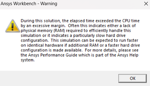

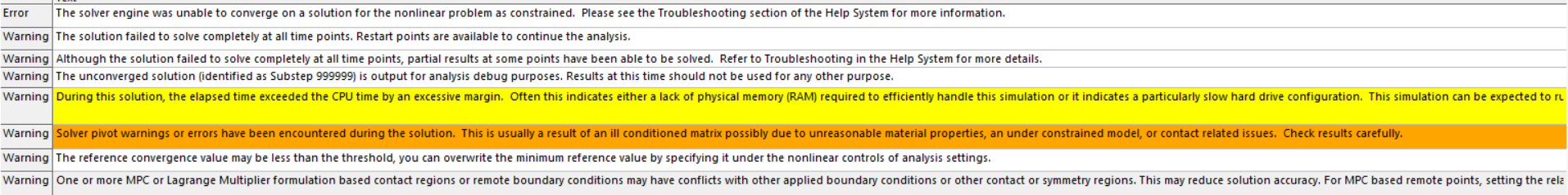

      Hello , I'm working on Simulating a real life Vee bending process done using a punch and a die on sheetmetal to find Spring back for my university project.
      I'm facing multiple errors which are shown in the screenshot attached( I have also added seperate screenshots of the errors that are too big). Could anyone pls guide me which type of simulation i should be doing(Currently im working on Static structurtal) and how to solve the errors.
      Software used- Workbench 2023 R2
      Thanks in Advance
    • Aniket
      Most of these are warnings and also include remedial measures in them. For example, the first warning shows to use better hardware. second one mentions about possible overconstraining in boundary conditions. Only first error is of utmost importance as the solution is not converged and the solution.
      Try searching errors in solver output file and searching them here on forum to check how those are resolved.
