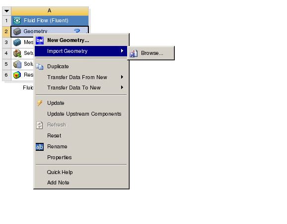

SubscriberYes this is a Linux machine but i am allowed to use the graphical user interface of workbench
May 13, 2020 at 10:30 am
MohamedKhaled1
Subscriber I got a message from our IT team that they can not find a license for spaceclaim for Linux machine.
Is there any way to get spaceclaim license for Linux machine. I am not sure if spaceclaim module needs a license or an activation to work on my university machnine
May 13, 2020 at 10:47 am
Aniket
Forum ModeratorSpaceClaim is not supported on Linux.
Maybe you can try using Free student version on your personal machine for geometry modelling and then transfer resulting wbpz file after reading in Mechanical to your Linux cluster.
-Aniket
