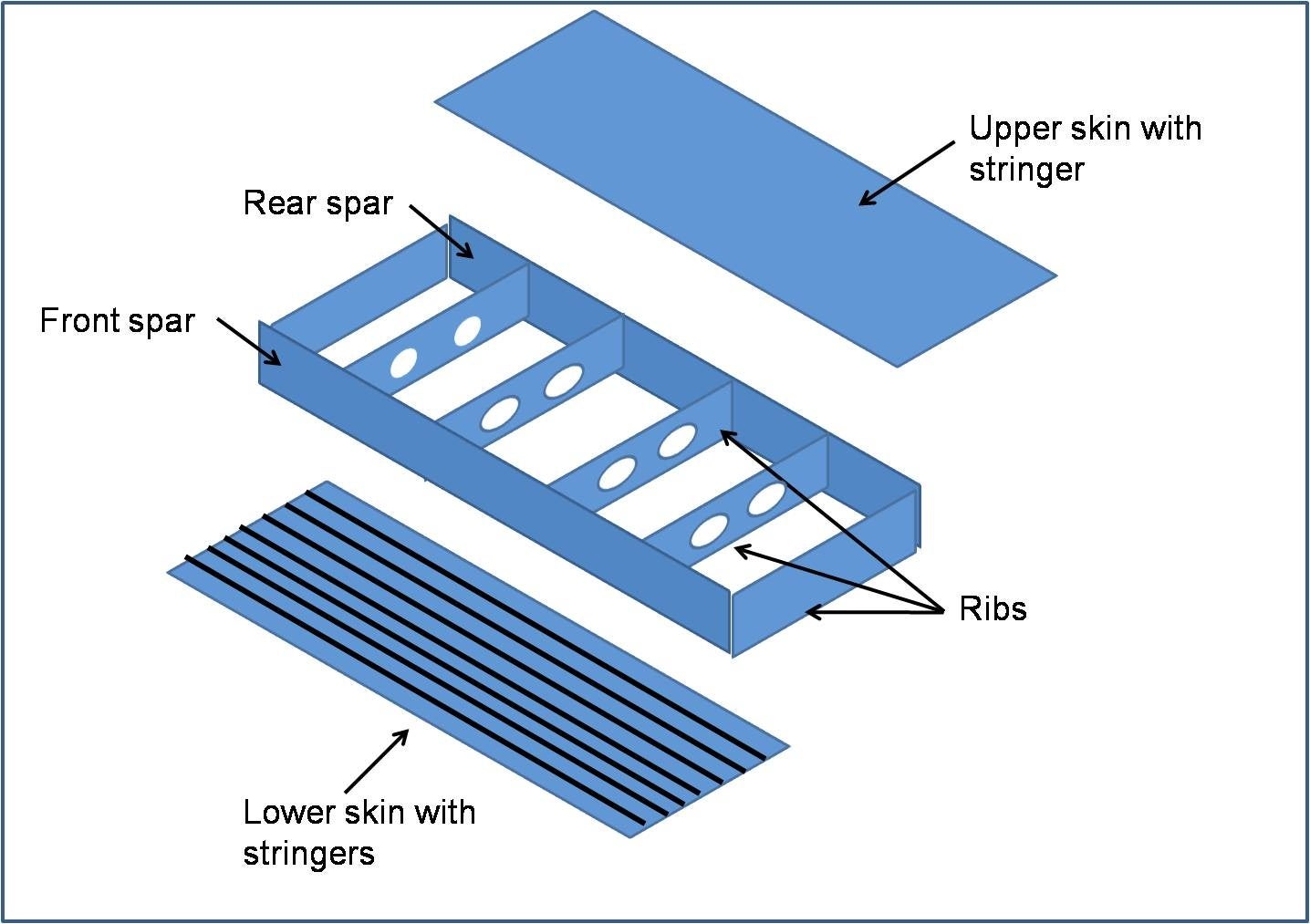

SubscriberJust a simple project based on previous studies where a wing box design for medium sized UAV made of Carbon Composite materials, unfortunately for me still unable to configure the geometry and model. Not to mention the optimization of Carbon Composite usage of material. Current model specs requested by lecturer :
Length = 4m, Width = 0.6m, Height = 0.12m, Thick = 0.001m
Consists of 7 interval ribs of 0.5m distances, thick = 0,001m

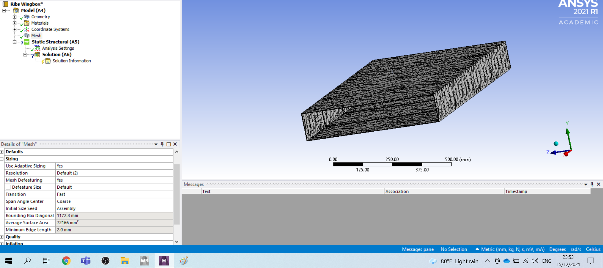

SubscriberI expect the lecturer's model is a surface model, and that the composite layups would be defined in ACP/Pre. His (her?) model has some curvature to the top and bottom faces. Do you need to include that? The lecturer's model has a tapered tip, what are the dimensions on the taper?
It looks like you have created a solid model, and meshed it with tetrahedral elements. You can discard that when you start over in DesignModeler.

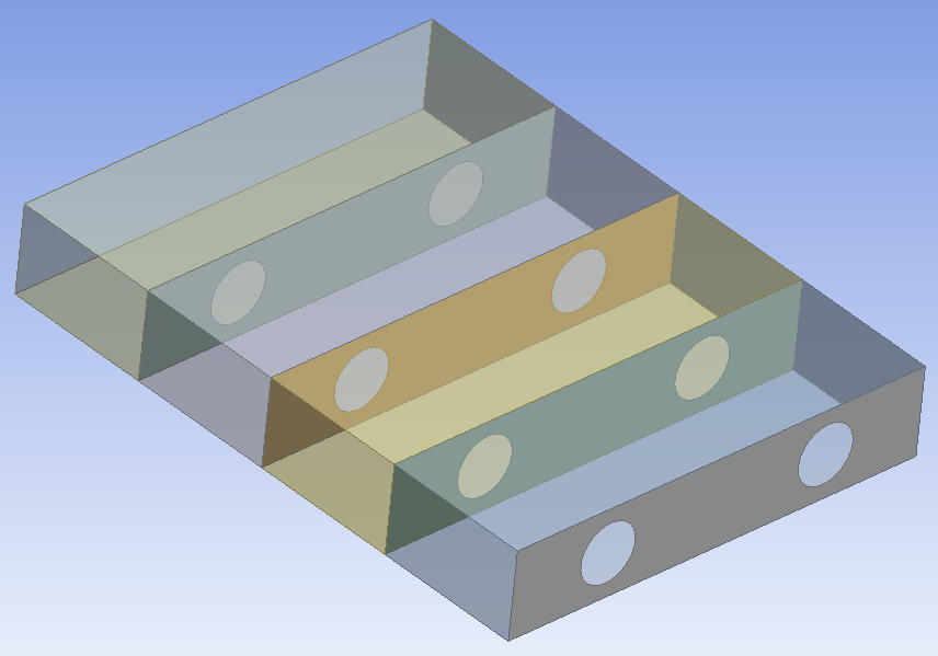

SubscriberYes Sir, the demo in youtube youve made was the progress im able to made but the internal ribs and other parts are still unable. It would really help if you could demo the ribs part, please Sir. The picture attached below is ribs consist of circular holes, im in need of square hollow frames inside of the wingbox (ribs)

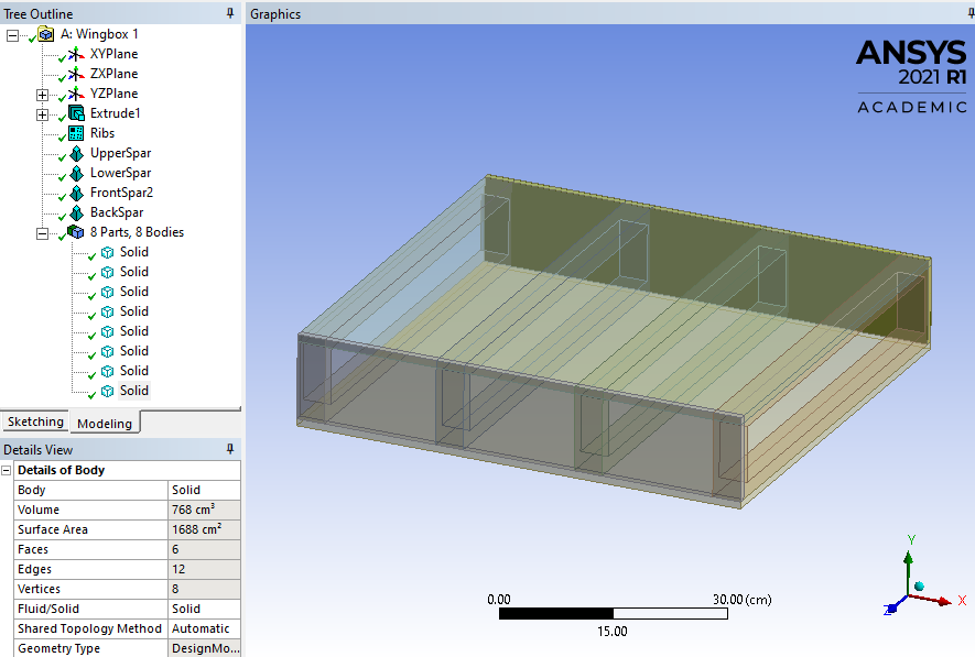

SubscriberAttached is the attempt ive tried in making the wingbox with ribs
January 7, 2022 at 12:18 pmpeteroznewman
SubscriberYou have created 8 solids for Wingbox 1. This is not what I demonstrated in my video. I created surface bodies, which is what you need to create shell elements and create a composite layup in ACP (Pre).
Independent of the geometry being solids and not mid-surfaces, the specification was that the ribs were to be 1 mm thick. The solid ribs are 20 mm thick. The spars are also supposed to be 1 mm thick and you made them 10 mm thick. The specification was 1 mm. Did you make a mistake when you said thickness 0.001 m?
