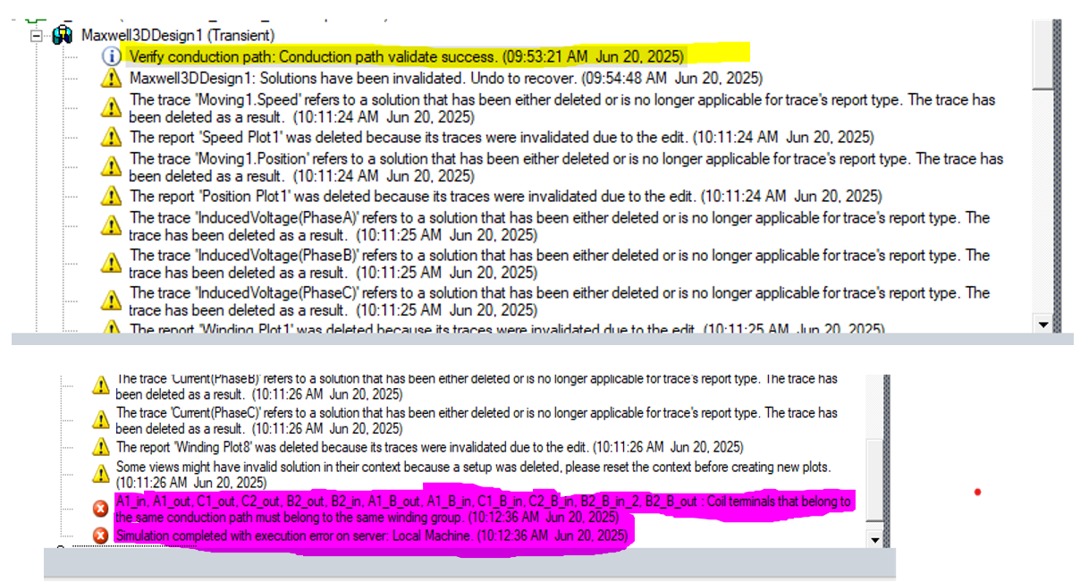

SubscriberHi all, I was modeling an 3D
PMSM with concentrated winding configuration (AA' C'C BB' A'A CC' B'B). I had simulated the similar winding configuration multiple times and the configuration was successfully validated each time.
But from today evening, when I'm trying this configuration for a new model, It is showing validation error, and this error is now coming in all my old models which were simulated successfully earlier.

SubscriberI hadn't changed anything related to windings. But made changes to rotor material.
For example, I opened one of my old maxwell file and did only winding validation, winding path was validated successfully. Later, I cleared all the previous solutions and tried to run complete simulation, the winding error is poping up. Attaching the image for your reference.

Ansys EmployeeHi Sai,
We need to look at the model and do some tests. It is not usual that a model that was working has this error by only changing the material in a different object (in this case, the rotor). Please open a support ticket in the Ansys Customer Case System (https://customer.ansys.com) so we can examine the model and help you efficiently.
