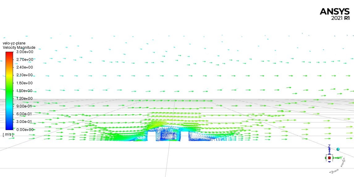

      I used the UDF file for the Wind direction and speed in transient mode. But the result looks not true while the upper wind speed is much slower than the building surrounding.  Below is my script for the UDF.
      Looking forward for your suggestions.
      Thanks a lot

      Plot the profile(s) that you've specificied above: do they make sense? What z coordinate is the ground in the Fluent model?

        Please explain more to me, I followed the Ansys manual for UDF so there're might be something wrong.
        Thanks
      Possibly. Starting point is to see if the profiles you used are correct: plot in Excel to see if they're giving the values you expect. Use the equations from the UDF and not what you wrote to create the curves in the first instance.
      • anhvu lee
        Dear Rob,
        It's true with this equations when tested on excel or the expression function of Ansys. I really dont know why
      The profiles are correct? I didn't follow your statement.
      What z-value is the ground, and what z-value is the sky? Use the surface reports in Fluent to find the values.
