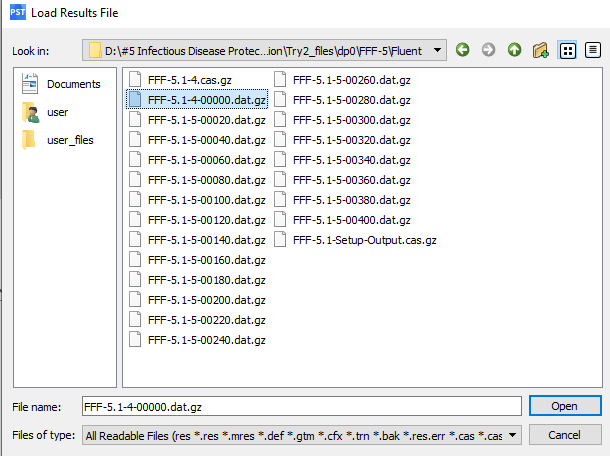

      Hi, nI'm new into DPM simulation. Currently, I'm doing a coughing simulation using DPM, transient-state. After finishing simulation and export particle data history (in .XML extension), I try to import it in CFD-Post to visualize. But, there isn't any particle track imported (even after select the file and click 'OK'). nI also try using particle-track graphics in FLUENT, but it only shows the latest time step particle location. nAnyone knows about this problem? n

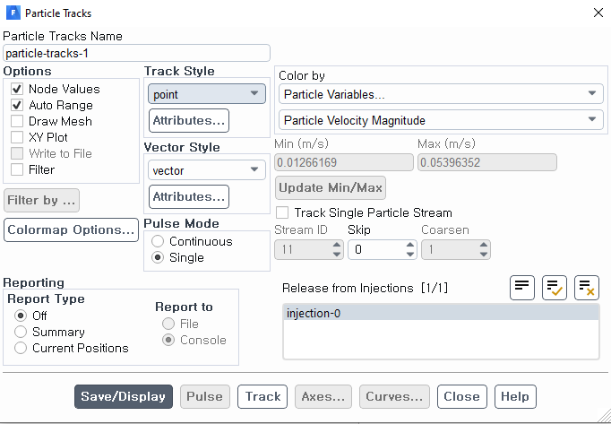

      If you plot the particles in Fluent are they working there? Note, as it's a transient model you'll see dots rather than the continuous tracks.n
    • gihrs
      Yes, Rob. Exactly true!nBut, how can I plot the particles for certain time-step? nSince with these settings (below), it will just show the latest time-step particle position nn
      Yes. You'd need to plot at the step of interest or have saved the data file and reload it. n

      Can you read case and data file before reading the xml file?n
    • gihrs
      In that case, I found this problem. I put the case and data file in /nBut, it turns out that some error happened. (like this screen-capture below)nn
    • Amine Ben Hadj Ali
      That is another problem: do you have case and data under the directory you want to read from? Is existent?nWhich version are you using? nI can confirm that I am able reading transient XML data into CFD-Post with the actual release.nYou might also create a dummy quick running case and try doing similar steps and reading XML: will that work? (Check if the issue case dependent)nn
    • gihrs
      Yes, Dr. Amine, I'm using ANSYS R1 2020 right now. nActually, I have the case and data under /, but it always give ERROR window even for .cas file or .datnnSo, is it related to the XML reading problem and its error? n
      Maybe because of the naming of your directory starting with #. Please move to a neutral directory and try again. Also try to read the last dat file and not the first one. Please use for this testing CFD-Post outside of the Workbench.nn
    • gihrs
      Hi, Dr Amine. nYes, I removed the '#5' in the name file. And, it works!nThank you for your guidance!n
