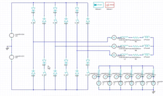

i got the automatically generated Maxwell 2d , but did not generate Maxwell circuit design
i want maxwell circuit design like this

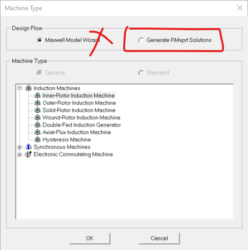

Forum ModeratorHi @denny9696 You might have used a design template from Maxwell model wizard while creating the RMxprt design you should select the template from Generate RMxprt solution.
If this did not solve your problem please specify which machine type you have used in RMXpert wizard or if any existing RMXprt example is used please specify which example you used.
Regards Navya
August 25, 2021 at 11:15 amdenny9696
SubscriberYes i use generate RMxprt
but not generation circuit design

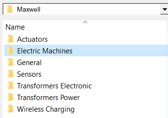

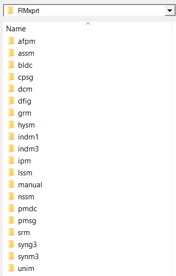

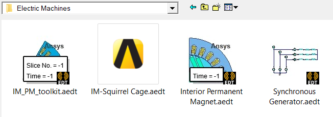

There are many examples available inbuilt for Rmxprt and Maxwell as well.
Go to file>open examples
Go to these folders and use the examples for the type of machine you want.
Regards Navya
