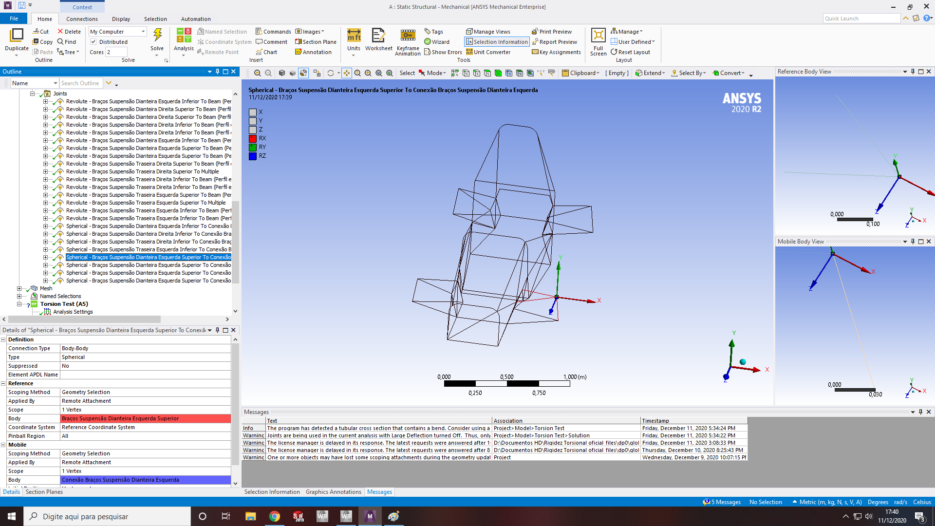

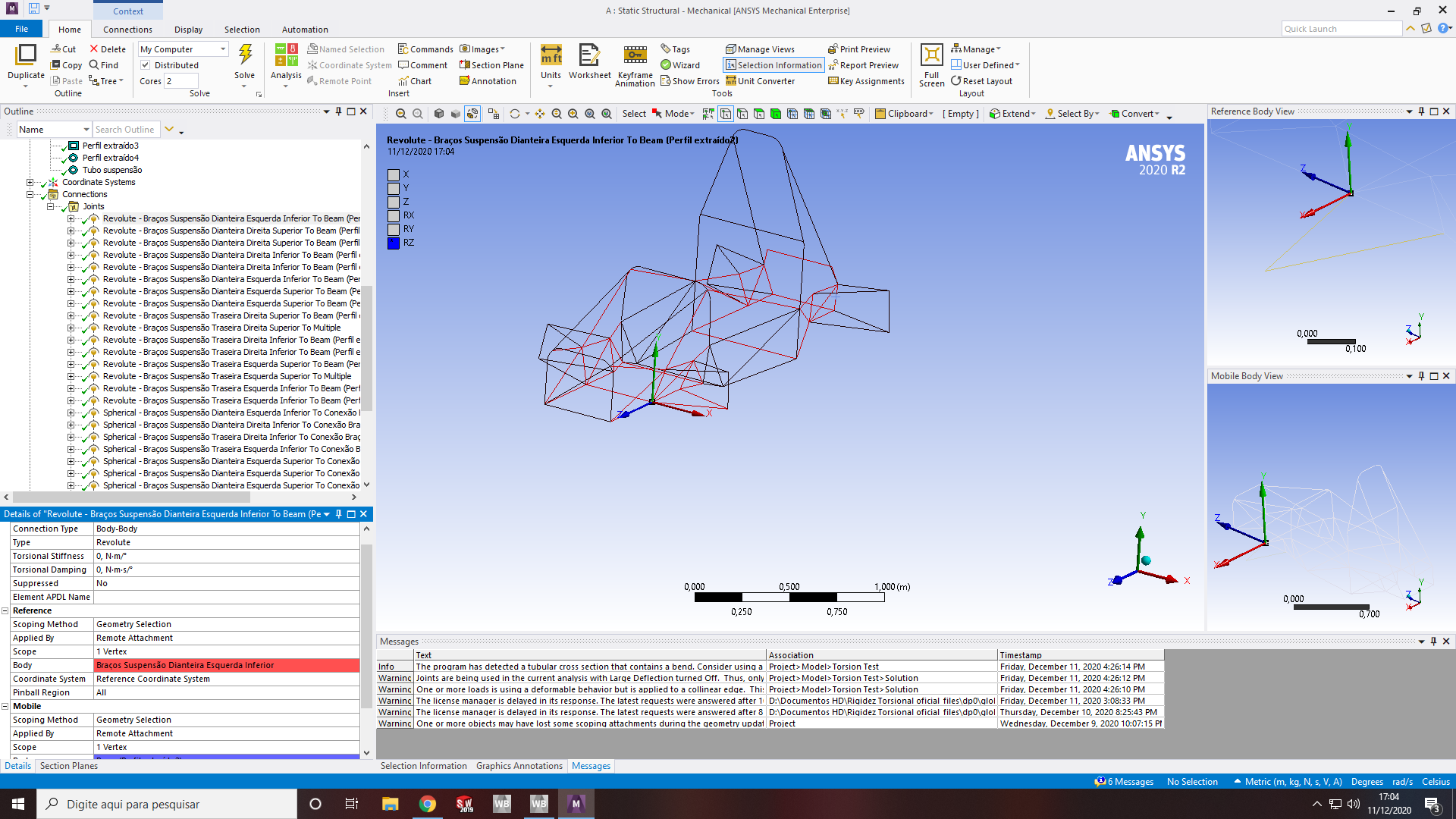

    • paganelli9
      nAnd I forget to tell: the only value that I'm adding in the model is the remote force. More images with details of the model:nThis is one of two types of joints I used, this one is revolute joint (connect the suspension arms in the chassis)nSpherical joint (connect the suspension arms in the wheel)nn
      nAh, this is the A-arm mechanism and there are spherical joints on the frame to allow the A-arms to move up and down.nOn a real car, there is a spring that builds up force as the road force at the wheel axle is applied. Do you have a spring? Adding a spring is the first corrective action for your model.nWithout a spring, there is nothing for the road force to push against, so the mechanism will go as far as it can.nStatic Structural has a feature called Weak Springs that automatically add springs to allow a mechanism to solve.nThe default for Static Structural is to use the Small Deflection assumption. With this assumption, a small motion in one direction is scaled without limit and the arm does not rotate about the joint. This model needs to use Large Deflection. Turn that on under Analysis Settings, which is the second corrective action for your model.n

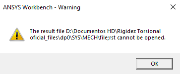

    • paganelli9

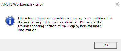

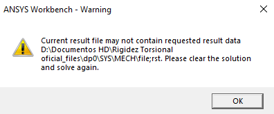

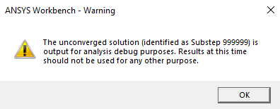

      Hi, sir! Thanks for your answer! The spherical joints connects the A-arms to the wheel, not on the chassis, the joints that connects the A-arms to the chassis are the revolute joints. I turned on the weak springs and the large deflection and I actually obtained far more realistic results, but I'm having some errors and warnings messages that I think it's related to the file. I will attached the images.nThe results are more realistics:nError message:nWarning messages:n(I already tried to Clear the Generated Data in Solution, but receive the same message above)nIt was all this messages that appeared. You know what I can do for solutionate this and run all the simulation? Again, thank you very very much for your help sir!n
      ArraynLook at the posts in the Google search of this site for the term unable to converge. There are many standard methods to resolve this situation.nhttps://www.google.com/search?q=site%3Aforum.ansys.com+%22unable+to+converge%22n

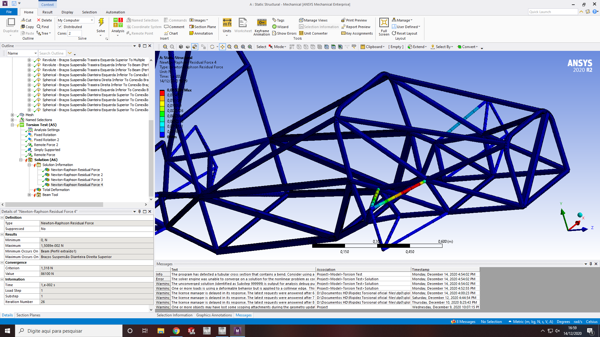

    • paganelli9

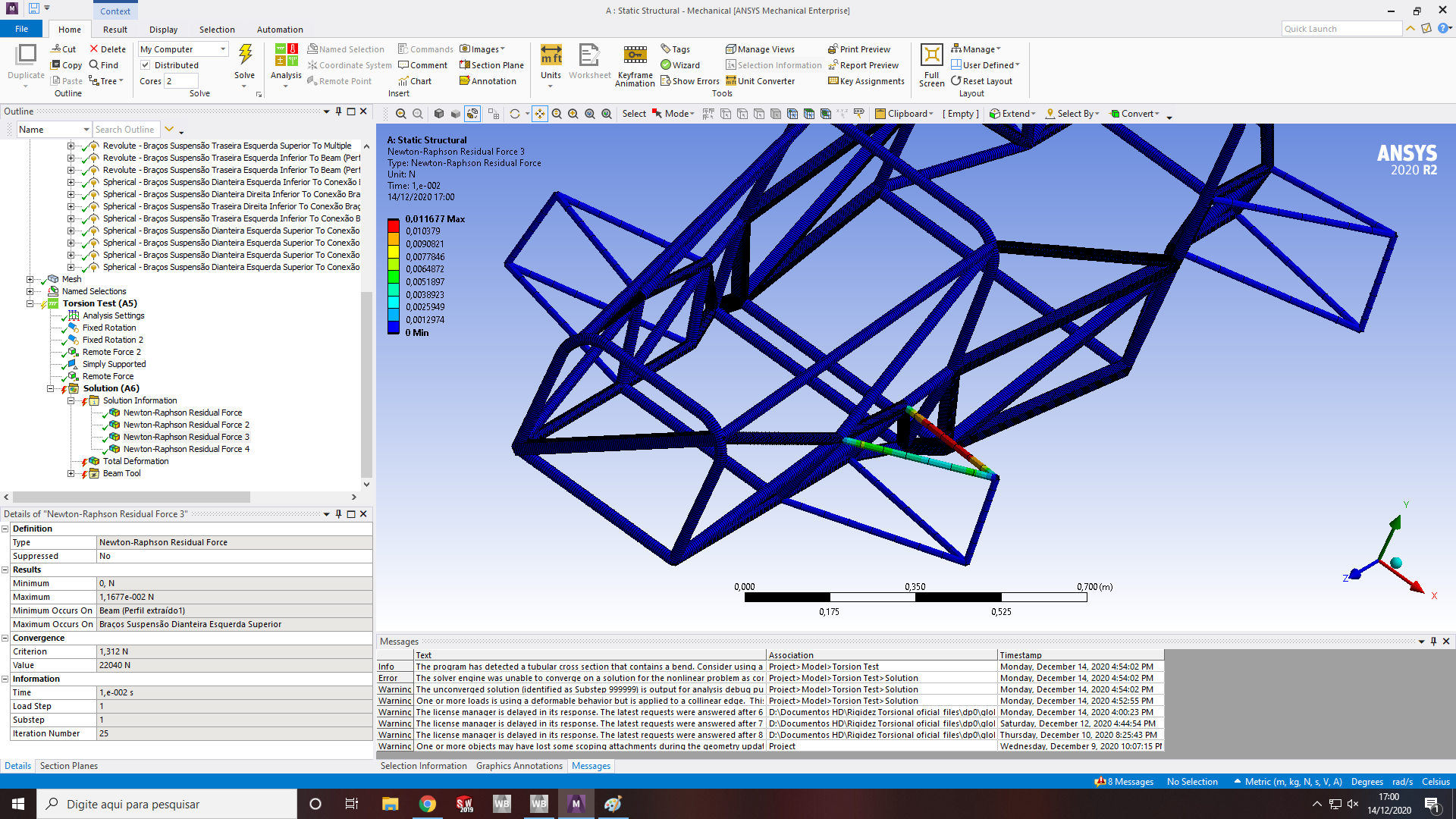

      ArraynHi sir! Thanks for helping me. So I tried a lot of different informations that I found in the link that you posted above, but I still couldn't run the model. So I put some Newton-Raphson Residual Force to check where the problem is and I find thesenDo you know what I can change in my model to solve this?nI'm also upploading the project archive if you wanna take a look.nArrayAgain, thank you very very much, Peter! Have a great day!n
      nYou missed my point about having to add springs in the A-arm mechanism to prevent them from being floppy.nSince you didn't add springs, I changed all the revolute and spherical joints to fixed joints to prevent the A-arm mechanisms from being floppy.nI picked one rear A-arm to be simply supported in XYZ, another to be supported in YZ and one front A-arm to be supported in Y. I applied a Force on the opposite A-arm of 3000 N and solved to find out the amount of twist in the frame. This is one way to measure torsional stiffness. If you want to clamp the frame the way you did and push up and down on the two A-arms with 1500 N, you can do that instead.nn

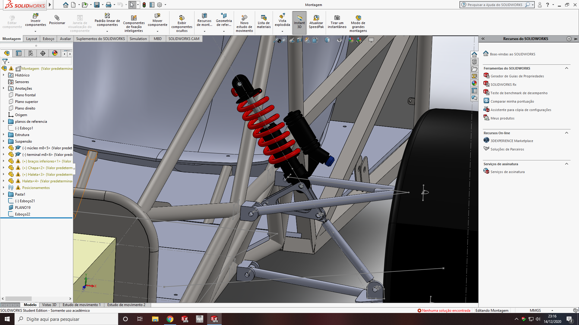

    • paganelli9
      ArraynHi sir! I actually saw your explanation about the springs, that's why I added the Weak Springs like you recommended.nOur car have springs, but they are mounted like this:nAnd I don't have a clue how to represent this in Ansys. I know how to put a spring, but only in a direct way (chassis to A-arm), not how it's in the picture. Do you know how I can represent this in Ansys?nThanks for your time and help, Peter!n
      nWeak springs are 1E-6 times smaller than the spring you need, so they may as well not be present. You need to put an actual spring into the mechanism.nThe image you show has two extra links: one a simple strut and another has three revolute joints. If you add those, then you can add the spring from the third point on that link to the fixed point on the frame.n

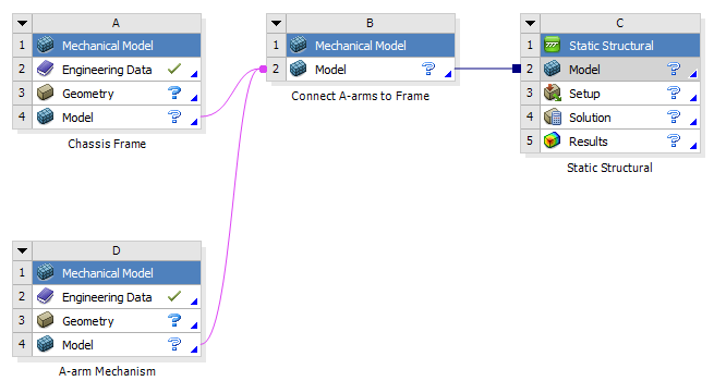

      nUse two Mechanical Models, one for the Chassis frame, one for the A-arm mechanism. Each one has its own mesh. You could even have three Mechanical Models if necessary. Link them into another Mechanical Model where the Revolute Joints can be defined. Then link that into a Static Structural where the loads and support can be defined.nn

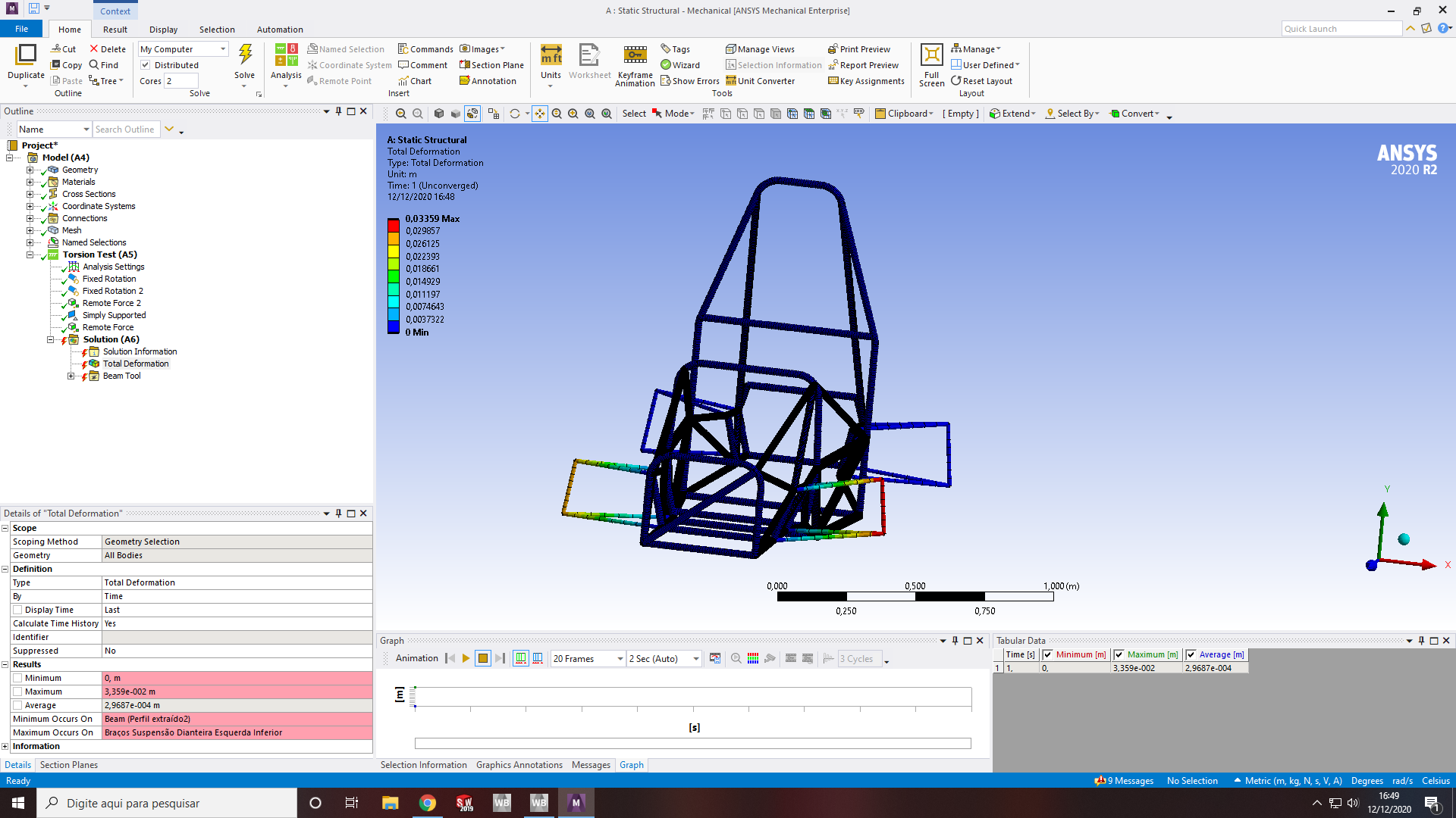

    • paganelli9
      Array nHi sir! So I don't think that the spring rate on the A-arm has something to do with the chassis stiffness, I actually saw a lot of torsional stiffness analysis with a lot less information than my model. I ran the model with all joints set to FIXED, but with the boundary conditions that you set before, but I don't think the results are reasonable in the chassis area.n
