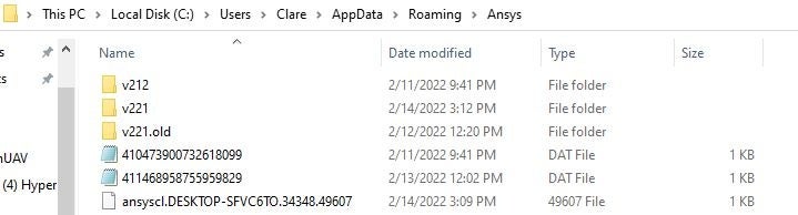

Forum ModeratorPlease run this command from an elevated CMD prompt (right click on CMD Prompt and ÔÇÿrun as administrator').
regsvr32.exe jscript.dll
Once this is done, reset the ANSYS configurations by renaming the %appdata%\ansys\v###

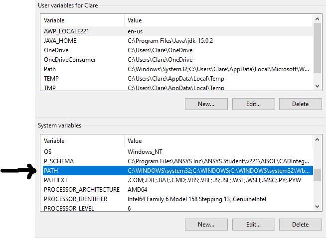

March 2, 2022 at 6:50 pmMangeshANSYS
Ansys EmployeeCan you please double check if under Environment variables System Variables the "Path" variable has these three entries listed before all else ?
%SYSTEMROOT%\system32
%SYSTEMROOT%
%SYSTEMROOT%\system32\Wbem
it appears that the entry in bold is either not present or not 2nd in order in the path
