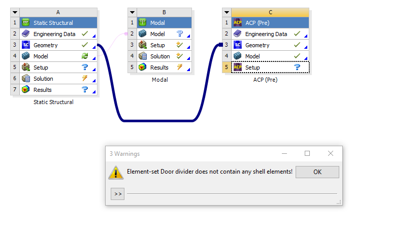

August 24, 2023 at 7:54 am
tumulpurwar
SubscriberWhy IÂ getting problem in setup module of ANSYS ACP PRE
Warning says: No layers generated, check if your model contains a valid layup.Â
