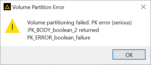

SubscriberI try to build a model in the new release from scratch, but run into another problem: when I try to partition the structure I get this error
After some experiments, I realized that once the number of domains goes above 10 or 11, adding another object is going to trigger this problem (partition has not issue with fewer objects). What is the solution here? Appreciate a prompt guidance.
Regards Chuan
August 20, 2021 at 12:59 amGuilin Sun
Ansys EmployeeMaybe you need to have a little overlap between to geometries, in particular if there is sphere or cylinder.

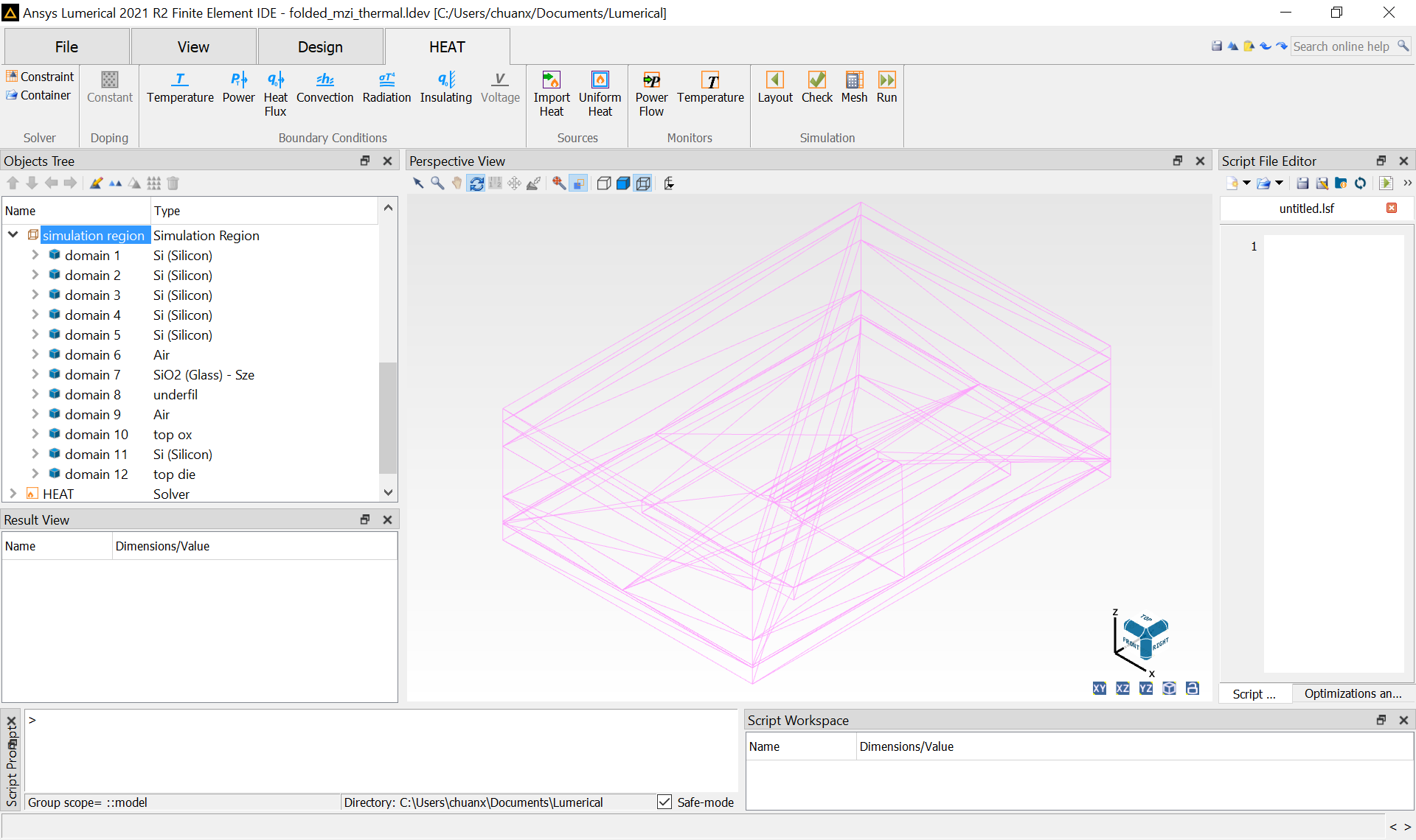

September 1, 2021 at 8:55 pmchuanx

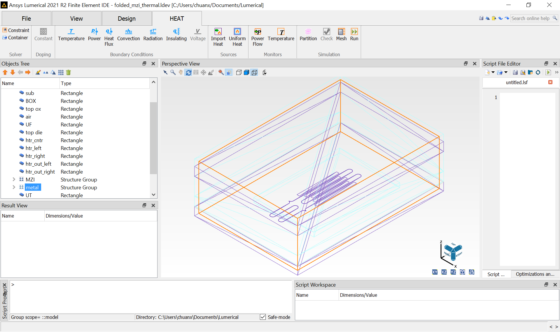

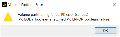

SubscriberHere is some updates on this topic. When I disable the metal group in my structure, I get partition error:

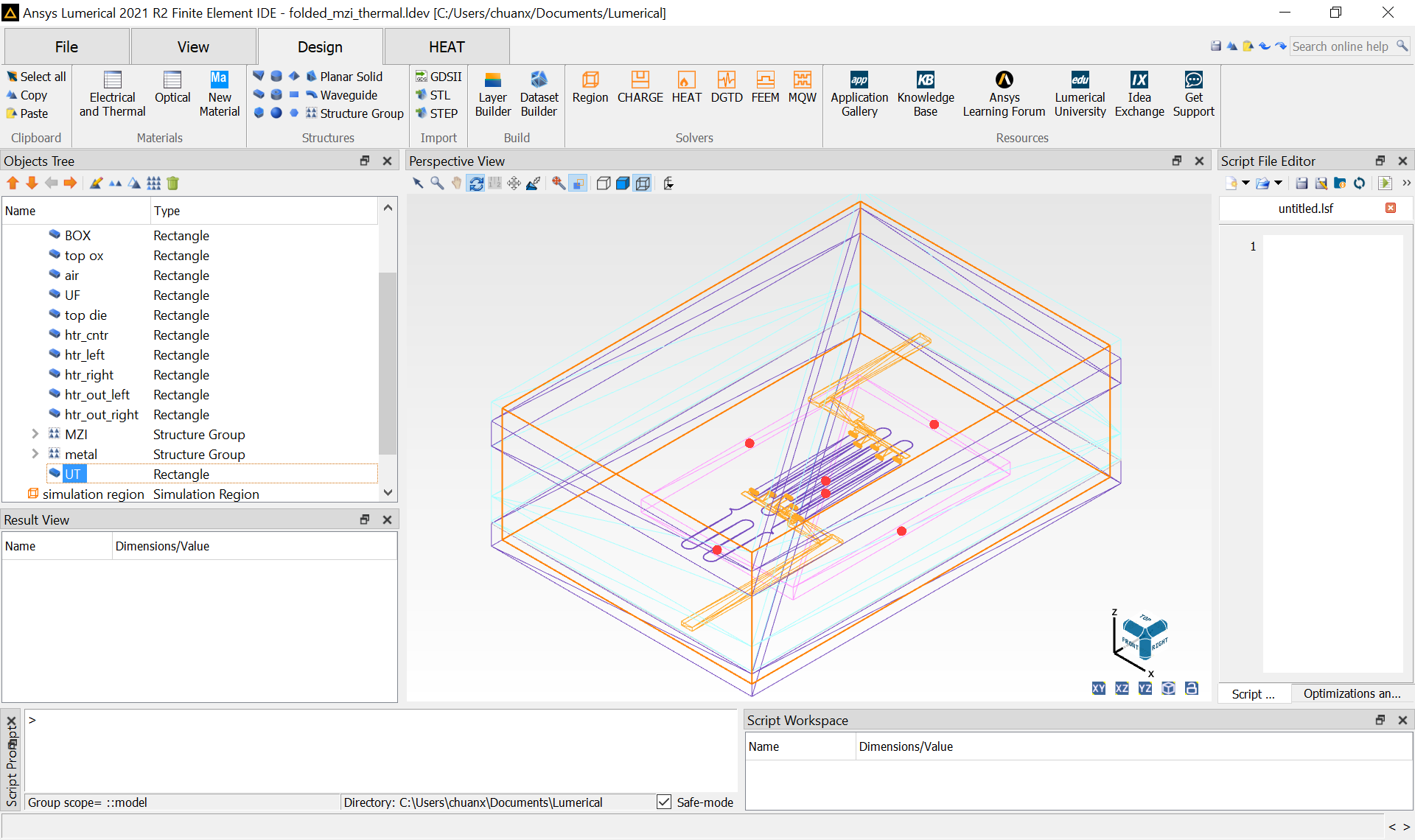

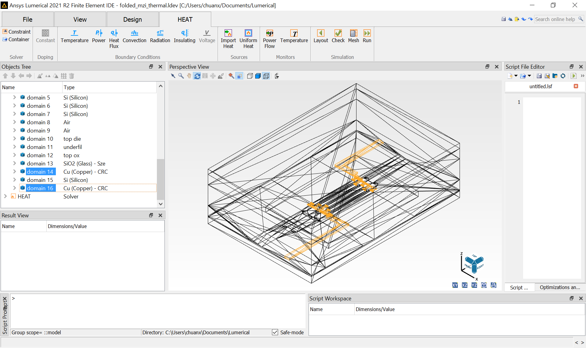

when I also disable the MZI group, partition works:
What's more intriguing is that if I enable both the "MZI" group and the "metal" group, partition works:
This at least explained one "mystery": why my model built in the older version of Lumerical does not have the partition issue.
Chuan

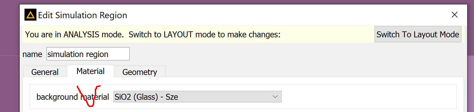

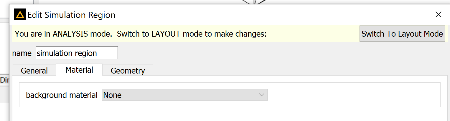

September 1, 2021 at 10:05 pmGuilin Sun
Ansys EmployeeI guess it is due to background material. For example, this file has SiO2 as background material:
If no background material is chosen, and no cover material like (all device is inside this material)
When you disable some objects, their original space is empty without material, then you will get the error message.
Please check if it is due to this reason.
September 1, 2021 at 11:19 pmchuanx
SubscriberI tried with background material (SiO2) or w/o background material (none) for the simulation region, and it makes no difference.
BTW, the object groups I disabled are embedded in SiO2 anyway, so disabling them will not leave a void.
September 2, 2021 at 12:00 amGuilin Sun
Ansys EmployeeThen check round objects and very small objects. Somehow the software cannot build up the geometry into the solver.
September 2, 2021 at 12:07 amchuanx
SubscriberThe dimension difference between the objects is quite large indeed. The Si waveguide layer is only ~160nm thick. The SM waveguides are 350nm wide. The other features, however, can be tens, even a couple of hundred microns in dimension. Would this be a problem? When you say very small objects, how small is small? The smallest dimension is 162nm.
Also, this does not explain why adding the metal group, which are a bunch of Cu pieces, makes partition to work.
September 2, 2021 at 5:07 pmSeptember 2, 2021 at 6:33 pmGuilin Sun
Ansys Employeewhen you have thin but long geometry, the meshing to have a quality finite element may have problems. You may need to use local meshing to use smaller mesh size there.
If the problem still exists, I would suggest that after disable some geometry, copy the active geometry to a new project. Or simple delete the disabled geometry. or build the device in a new project file. Currently I have not found any documentation about this error.
Partition is the first step in meshing, to recognize the geometry in solver. It is also possible that in some case the software has a bug. If the error does not prevent to run the simulation, it is ok to continue the simulation to get result. If the simulation cannot continue, you may disable the objects outside the simulation region, or delete them. You may test it by disabling/enabling each of them and identifying which geometry/material causing this issue.

October 6, 2021 at 1:31 pmDemjango
SubscriberDear Everyone I am experiencing the same issues with the same error "PK_BODY_boolean_2 ...".
I have created 2 structure groups so that i can use parameters to change important features of the design. If try to partition the structure I receive the same error, but if i disable any of the structures i "resolve" the issue. Actually the solution I adopted was to disable the surrounding Air rectangle and I have imposed Air as background material.
I think this issue should be tackled asap. What if one needs to simulate a more complex structure?
October 6, 2021 at 6:47 pmGuilin Sun
Ansys EmployeeThis error "PK_BODY_boolean_2 ..." is due to the meshing algorithm, and the original provider is working hard to resolve it. Once we get their newest version with this issue fixed, we will have new release. Please be patient.
