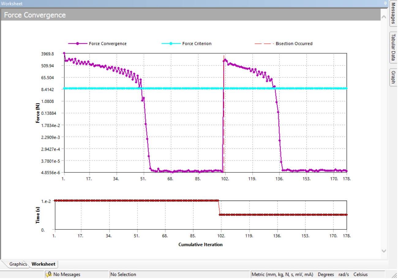

SubscriberI have a simple structural loading structure consisting of beams and shell (representing human skeleton bones). It was running good until I changed a few material properties and loading and from one of my modifications which I do not remember what was it, Ansys solver keeps saying:
FORCE-DISTRIBUTED CONSTRAINTS DO NOT SATISFY COMPATIBILITY CONDITION
Though the force has converged. Can anyone tell me on which occasions this happen and how can I solve it?

Ansys EmployeeHello Array,
Could you explain the model setup? What kind of elements have you used and how have you connected different parts? Also give info regarding loading and boundary conditions. Could you go through the warning message in the solution information and see if it points to any specific connection?

SubscriberHi, Thanks the problem was adding a remote connection point I had just defined it for an analysis and forgot to remove it, when removed everything is fine now.
