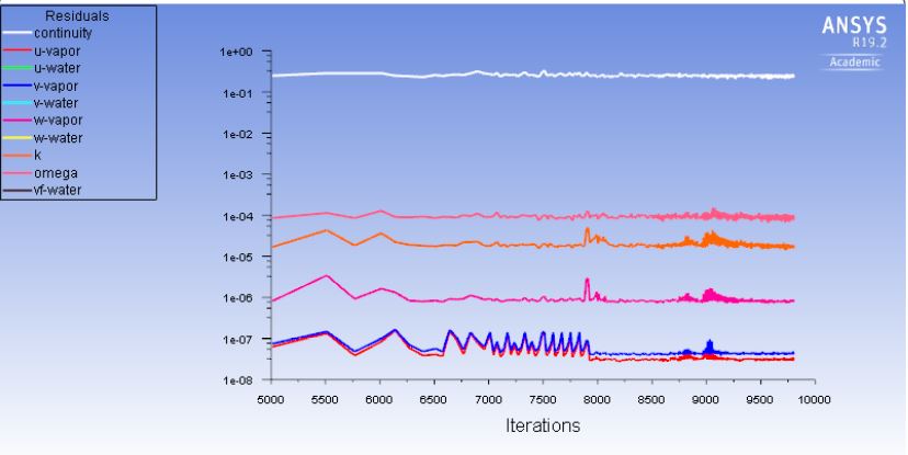

      Greetings! I am using EWF and DPM to model annular flow.
      For EWF , I got these information ANSYS user guide:
      1.The material properties for the secondary phase should be the same as the DPM particles.
      2.The name of the secondary phase material should be included in the name of the DPM particle’s material and should be appended with the string ‘-particle’ (for example, if the secondary phase material name is waterliquid- eulerian, then the DPM particle’s material name should be waterliquid-eulerian-particle).
      3.The wall film cannot be solved without first initializing the wall film model (using the Initialize button) to initialize the wall film variables and prepare the solver for the solution procedure.
      I am using vapor as primary phase and water as my secondary phase and droplets .
      Here is the short description of model:
      "The simulation includes a two-dimensional Eulerian liquid film model coupled to a three-dimensional core model (including vapor flow and droplets) based on the Eulerian – Lagrangian approach"
      Please see the attached image and would you give me any idea why I am not getting any residuals for liquid phase? Why the model is not showing data for wall film?(I know know it's not converging but that is not my concern now ,I can change other setting but I want to see the residuals for water)
      Thank You,
      Anadi
    • Surya Deb
      Hello, Not really sure what is the issue here. I see all the proper residuals being displayed. I also see the volume fraction and velocity residuals of water.nThat is all the residuals that you need. You will be able to visualize EWF variables in Contours separately as well.nRegards,nSDn

      Thank you sdeb!nHere you are seeing 6 residual curve (3 for vapor, one for continuity, one for k and final one for omega). I check the values for water in console ad it is zero. I have attached two images . I have tried to draw film thickness but not getting any single graph. Will you check the parameters ? I draw the pipe on XY plane and extrude in z direction. I have attached tube with zone for your convenience. I apply liquid mass flux at injection wall by EWF option. Mainly I need to draw wall film thickness of water and mass flow rate of water in annular section.nRegards,nAnadinn
    • Amine Ben Hadj Ali
      Please plot first along a line and not the wall surface.nMoreover I am aware that some problems in the past related to EWF have been fixed during the last versions. Please update to the most recent version.nnWhat do you want to do?n

      I understand but why are you solving Eulerian Multiphase here if your core is (DPM) particle laden gas flow?.Doing XY Plot on surface is not pretty as you saw. Rather first check the contour plots of film thickness.n

      Hello Array nI was getting this error,nDivergence detected in AMG solver: pressure couplednError at host: floating point exceptionnSo I am trying to find where is the error? This time I did not use UDF and DPM. I just use EWF and water-vapor in the core for test purpose. I check the contour and a think film is noticeable. But when I am trying to plot the film thickness, I am getting the following graph. Did I do any mistake to take the surfaces(X-axis)? How can I get a single graph of film thickness on the wall? or what is the way to plot film thickness? I plot the tube in XY plane and extrude in Z direction. If you need to know the mesh ,please see the 2nd top image of this post. If I can plot the film thickness, then I will turn on the DPM next.nThank You,nAnadin
      You tend to plot thickness on the wall, and use local range. For an xy plot you need a line, the easiest way is to create a plane (or iso-surface of mesh) and select the wall when you do that. The result is the intersect of the two surfaces which tends to be a line. nDivergence will be because the time step is large relative to the amount of vapour moving to the film. Time scales tend to be VERY small, so just keep dropping the timestep by an order of magnitude until it works. Also look at sub-stepping in the film set up. It's an area we're actively working on, and I'm waiting on the build so I can start testing the new options. n

      and nI create a line at the wall of the tube and getting film thickness as below. I see at some location film thickness is zero. Do you think the high velocity of vapor (12m/s)in the core is responsible for that? Actually I am expecting a stable (almost parallel line) film thickness on the wall as I did not apply any heat flux to evaporate the film yet and allowed enough time to form stable film .nMoreover, I am using water-liquid as film materials and flowing water-vapor in the core from inlet.nI am using university vLabs .I see 19.2 is the most updated version there.nThank you,nAnadinn
