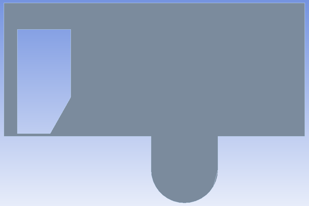

in my simulation I have a wall, moving with a constant velocity in x-direction. To do that I wrote a motion profile and put that profile in dynamic mesh (rigid body motion). I use the VOF-method in my simulation, therefore a small timestep-size is needed. After every 5 timesteps i plot the wall velocity and when the timestep size is very small, the wall velocity stays at 0m/s.
