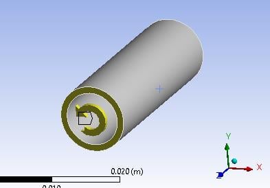

      I have a question regarding remote displacements and the resulting force/ moment reactions.
      I was experimenting a bit with the file provided in this  post. I modified it such that I apply a purely rotational remote displacement around the z axis.
      As output I probed force and moment reactions as bounding condition at the point of displacement. Since it is a purely rotational displacement, I would expect only non-zero moment values (Mz). However, the force reaction additionally states a non-zero force.
      When further experimenting,  I found out that in "Details of Remote Displacement", when I set X Y Z Components to free, the force disappears. Can someone explain why this happens?

      Your expectations were wrong.
      If X is free and the solution shows there is movement in the X direction, setting a constraint of X=0 will require a reaction force to achieve that constraint.
      Only in a very special case where X is free but the solution shows there is no movement in the X direction will setting a constraint of X=0 require no force.
