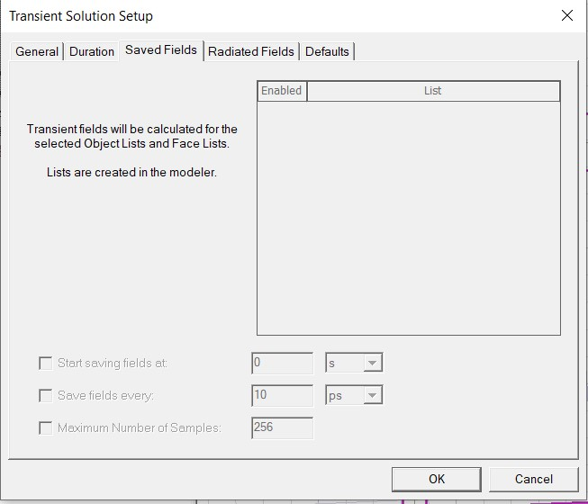

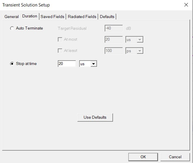

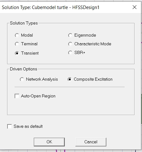

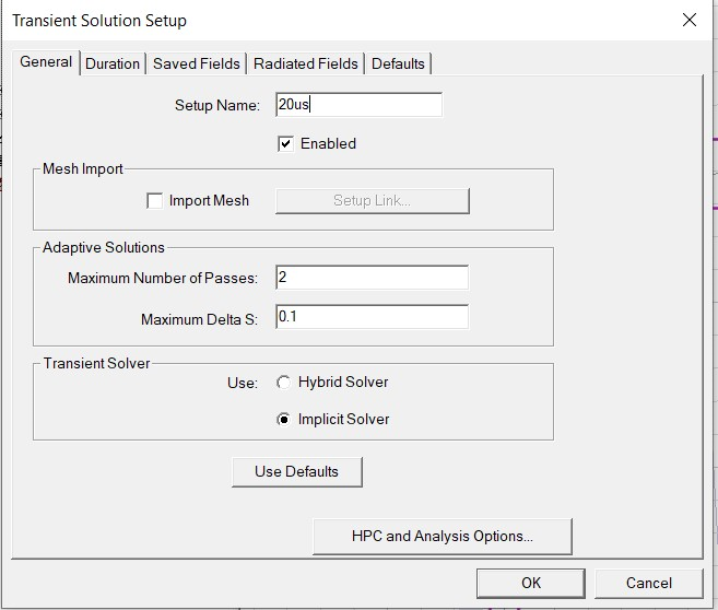

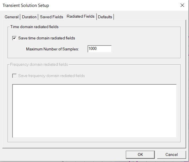

ArrayHere are screenshots of my Solution Type and Solution setup. As I am looking at it, I am realizing that I might know what the problem is. I think my problem is the Saved Fields solution setup. In order to simulate the electric fields on any object, do I need to add that object to the list and enable the saving of fields? n

Ansys EmployeeHiArray,nPlease create a object or face list to enable the save fields option for Transient analysis. Go through Creating an object list section in the HFSS Help PDF document for detailed information. You can also go through Adding a Solution Setup for Transient Solutions section for more details from the same HFSS help document.nAll the very best.nBest Regards,nViewing 6 reply threads- The topic ‘Why does it not allow me to plot the E Field in HFSS?’ is closed to new replies.
